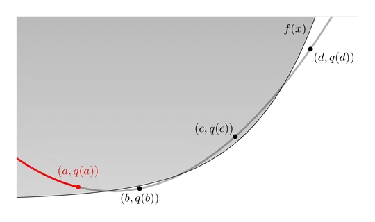

  • Q3. For any $a<b<c<d$ and a quadratic function $q(x)$ if both of the points $(a,q(a))$ and $(c,q(c))$ are contained in $\mathop{epi}(f)$ whilst both of the points $(b,q(b))$ and $(d,q(d))\}$ are outside of the epigraph then the graph of $q|_{(-\infty,a]}$ is contained in $\mathop{epi}(f)$.

  • Condition Q3 is an attempt to formulate Q2 by referring solely to the epigraph of $f$ and not its boundary – the graph of $f$ – similarly as convexity of a set $S$ is usually defined by requiring that any segment connecting any two points in $S$ is contained in $S$ (instead of requiring this property only for any two points on the boundary of $S$). Notice that the graph of a quadratic function can be characterized as a parabola with a vertical axis of symmetry.

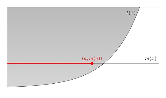

Increasing Functions:
  • I0. The derivative $f'$ exists almost everywhere and is positive on its domain.
  • I1. The function $f$ is increasing.
  • I2. For any $a\in \mathbb R$ and the constant function $m(x)$ interpolating the point $(a,f(a))$, the graph of $m|_{(-\infty,a]}$ is contained in $\mathop{epi}(f)$.
  • I3. For any $a\in \mathbb R$ and a constant function $m(x)$ if the point $(a,m(a))$ is in $\mathop{epi}(f)$ then the graph of $m|_{(-\infty,a]}$ is contained in $\mathop{epi}(f)$.
Note that Condition I3 is equivalent to $\mathop{epi}(f)$ being star-shaped with the vantage point $(-\infty,0)$ at the infinity. In other terms $\mathop{epi}(f) = \mathop{epi}(f) + (-\infty,0]\times\{0\}$. (The vantage point at infinity represents a direction, since the direction is parallel to the $x$-axis, it is possible to informally describe the vantage point as $(-\infty,0)$ instead of representing it in the homogenous coordinates as $(-1,0,0)$.)
