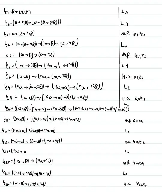

This is the solution: please let me know if the handwriting is unclear: enter image description here
H.S
  • 51
