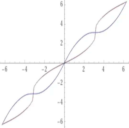

$$\bbox[3px,border: 5px groove blue]{f(x)=\sin(\sin(x))+x\implies f^{-1}(x)=x+2\sum_{m,n=1}^\infty\frac{(-1)^n+(-1)^m}{n}\sin(nx)J_m(n)J_n(m)}$$
Graphing shows the inverse function:
Therefore:
