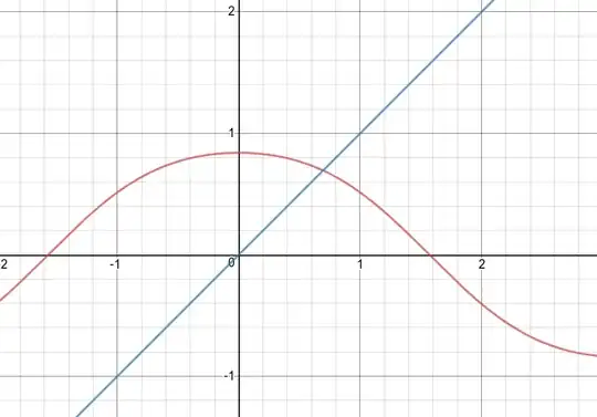

It's easier to represent this sequence as follows: $x_0=0,x_{n+1}=\sin(\cos(x_n))$. The value this sequence converges to is called a fixed point. A fixed point, $x$, of the function $f$, is a value such that $f(x)=x$. In your case, $f(x)=\sin(\cos(x))$. The fixed point could be interpreted, with the figure below, where the red curve is $y=f(x)$ and the blue line is $y=x$. The point of intersection of the line and the curve is the fixed point. This could give one possible explanation for the fixed point: the red curve lies above the blue curve to the left of the intersection, but lies below the blue curve to the right of the intersection.* In other words, since $f(0)>0$ but $f(1)<1$, there is a fixed point in the interval $(0,1)$.

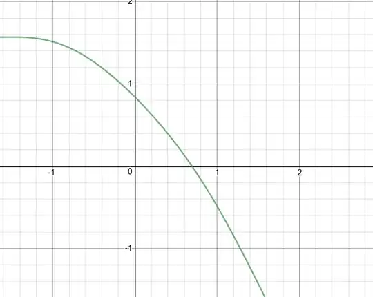

Relation to Roots of Functions.
If $f(x)=x$, at the fixed point, then $f(x)-x=0$. We can name a new function, $g(x)=f(x)-x$. Hence, another interpretation of the fixed point is the value of $x$, which is a root of the function $g(x)$. The graph of $y=g(x)$ is shown in green below. This way of describing the fixed point is directly related to the formulation before, but now, the fixed point is the intersection of the green curve with the $x$-axis. And, similarly to before, since $g(0)>0$ but $g(1)<0$, there's a fixed point in the interval $(0,1)$.* Since fixed points are equivalent to a root-finding problem, it's possible to use more sophisticated root-finding algorithms to find the value of the fixed point. The algorithm in question will depend on properties of the function, such as continuity and differentiability. It may also be possible to generate an infinite series for the fixed point by the Lagrange Inversion Theorem.
