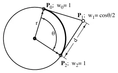

However, if you're willing to consider a Bézier curve in 3D which forms a perfect circular arc when viewed from the correct point (i.e. with a perspective projection; this is also known as "rational Bézier curves"). E.g. these notes show how to construct any conic section with rational quadratic Béziers.[Now 404s and not in archive.org].
And these notes handle the case of a circular arc explicitly: Diagram of circular arc as quadratic rational Bézier curve
This works for $\theta < \pi$ (or $\theta = \pi$ using homogeneous coordinates); for a full circle, you need more than one arc.
