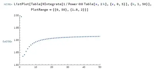

Obviously, one method of attack is to show that if $f_1(x)=x^x$ and $f_{k+1}(x)=x^{x^{f_k(x)}}$, then
  1. $\int_0^\infty dx/f_{k+1}(x)>\int_0^\infty dx/f_k(x)$ for each $k>1$, and
  2. $\lim_{k\to\infty}\int_0^\infty dx/f_k(x)<2$.

  • The first step in the method above means that the area gained in the interval $(0,1)$ is greater than the area lost in $(1,\infty)$. It appears that the consecutive differences (plotted below as %97) $$\int_0^\infty\frac{dx}{f_{k+1}(x)}-\int_0^\infty\frac{dx}{f_k(x)}$$ decay on the order of $k^{-\log k}$, and decrease monotonically in most instances as well.
    I have now cross-posted this problem on MathOverflow.
  • For the second step, the limiting case turns out to be very easy to prove. We have $$\lim_{k\to\infty}\int_0^\infty\frac{dx}{f_k(x)}<\lim_{k\to\infty}\int_0^\infty\frac{dx}{g_k(x)}=-\int_0^\infty t\cdot\frac d{dt}\frac1{t^t}\,dt=\int_0^\infty\frac1{x^x}\,dx<2$$ where $g_{k+1}(x)=x^{g_k(x)}$ and $g_1(x)=x$.

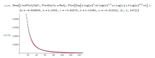

    Nice question (+1) For more than $15$ $x's$, we can safely replace the interval to $[0,3]$ without making a significant error , probably even smaller than $[0,y]$ with some $y<2$. But whether we can calculate those integrals numerically, is another story. The function just gets too big. – Peter Feb 15 '22 at 18:04
  • The sequence of values seems to become almost stationary although the power tower oscillates for small values between two accumulation points depending on the number of entries. How can this be explained ? – Peter Feb 15 '22 at 18:31
