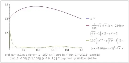

This approach is based on the intermediate inequalities, which follow from the series representations.
Using inequality $$x^{-x}\le1+(\sqrt[e]e -1)ex(2-ex)+ \frac{116-ex}{635} \sqrt{e x} (ex-1)^2,\quad\text{if}\quad x\in[0,1],\tag1$$ Approximation 1
one can get $$I_1 \le \dfrac1e\int\limits_0^e (1 + (\sqrt[e]e - 1) (2 y - y^2) + \dfrac{116-y}{635} \sqrt y\, (y - 1)^2)\,\text dy,$$ $${\small I_1 \le 1 - e + \dfrac{e^2}3 + \sqrt e\left(\dfrac{232}{1905} - \dfrac{466 e}{3175} + \dfrac{236 e^2}{4445} - \dfrac{2 e^3}{5715}\right) + \dfrac{\sqrt[e]e (3e-e^2)}3 < 1.291733}\tag2$$ (see also Wolfram Alpha integration).

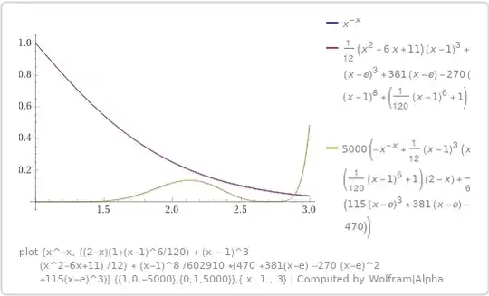

If $\;x\in[1,3],\;$ then $$\begin{align} &(2-x)\left(1+\dfrac1{120}(x-1)^6\right) + \dfrac1{12}(x-1)^3 (x^2-6x+11)\\[4pt] &+ \dfrac1{602910}(x-1)^8(470 +381(x-e) -270 (x-e)^2 +115(x-e)^3) -x^{-x} \le 0, \end{align}\tag3$$ Approximation 2 $$\begin{align} &I_2 = \int\limits_1^3 x^{-x}\,\text dx \le \int\limits_0^2\bigg(1-y)\left(1+\dfrac1{120}y^6\right) + \dfrac1{12}y^3 (y^2-4y+6) + \dfrac1{602910}y^8\\[4pt] &\times\bigg(470 +381(y+1-e) -270 (y+1-e)^2 +115(y+1-e)^3\bigg)\bigg)\,\text dy = \bigg(\dfrac{y^9}{5426190}\\[4pt] &\times\left(\dfrac{345}4 y^3 - \dfrac{135(23e - 5)}{11} y^2 + \dfrac{27(62 - 50 e + 115 e^2)}{10} y + 696 - 186 e + 75 e^2 - 115 e^3\right) \\[4pt] & - y^8/960 + y^7/840 + y^6/72 - y^5/15 + y^4/8 - y^2/2 + y\bigg)\bigg|_0^2, \end{align}$$ $$I_2 \le \dfrac{2 (61687647 - 11159040 e + 4899840 e^2 - 809600 e^3)}{149220225} < 0.687550.\tag4$$
At last, $$I_3 = \int\limits_3^\infty x^{-x}\,\text dx = 3\int\limits_0^\infty (3+3y)^{-3-3y}\,\text dy = 3\int\limits_0^\infty3^{-3-3y}(1+y)^{-3-3y}\,\text dy$$ $$I_3 \le \dfrac19\int\limits_0^\infty \dfrac{27^{-y}}{(1+y)^3}\,\text dy = \dfrac{1-3\ln3\,(1 + 81\ln3\, \text{Ei}(-3\ln3))}{18} < 0.018865\tag5$$ (see also WA integration)
From $(2),(4),(5)$ should $$I=I_1+I_2+I_3 < 1.9982 <2.$$
