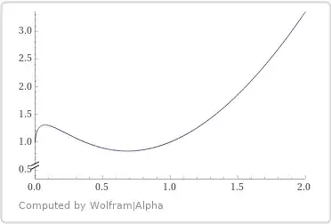

    Just mentioning that this can not be generalized further. Plots with WolframAlpha show that ${^{n}x} \ge (x^2+1)/2$ for $n=2, 4, 6$, but not for $n=8$. – Martin R Jun 07 '21 at 07:18
    This is what I see for $n=8$: https://www.wolframalpha.com/input/?i=plot+x%5E%28x%5E%28x%5E%28x%5E%28x%5E%28x%5E%28x%5Ex%29%29%29%29%29%29+%2C+%28x%5E2%2B1%29%2F2+from+0+to+1 and the inequality does not hold near $x=0.2$. – Martin R Jun 07 '21 at 08:11

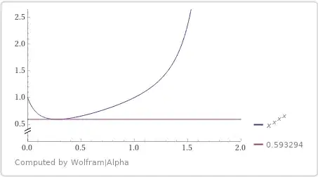

Graph: Here
Demonstration: At the end.

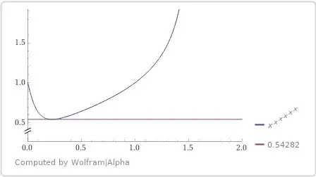

Case 2: When $x \in [0, 0.25)$, we have $$^6x> 0.534 >1/2( 0.25^2 +1) \ge \frac{1}{2}(x^2+1)$$ So this case holds.
Case 3: When $x \in [0.5,1)$
Consider the function $f(y)=\ln( e^y+1)$ on $(-\infty,0)$. Because its third derivative $f^{(3)}(y)=\frac{e^y(1-e^y)}{ (1+e^y)^3} $ is positive, we have the following usual inequality $$\frac{f(y)-f(z)}{y-z} \ge f'\left( \frac{y+z}{2}\right)$$ Choose $y=\ln(x^2),z=0$, we imply that: $$\frac{ \ln( (x^2+1)/2)}{\ln(x^2)} \ge \frac{x}{x+1}$$ or (note that $0<x<1$) $$\frac{x^2+1}{2} \le x^{ \frac{2x}{x+1}}$$ Besides $$^6x > x^{x^{0.5877}}= x^{ x^{0.5877}}$$ which implies the sufficiency to show $x^{0.5877} \le \frac{2x}{x+1}$, or $$2 \ge x^{0.5877} +x^{-0.4123}$$ Where the maximum of RHS on $(0.5,1)$ is easy to be analysed, which is in fact achieved at $x=1$, thus the ineq holds. See the graph here
Case 4 $x \in [0.25,0.5]$
As argued in the part 3, $^6x > x^{x^{0.5876}}$( I take $0.5876$ instead of $0.5877$ because it's nicer for later), it suffices to show $$\frac{\ln(x^2+1)-\ln(2)}{\ln(x)} \ge x^{0.5876}$$ on $[0.25, 0.5]$ or $$2\frac{\ln(y+1)-\ln(2)}{\ln(y)} - y^{0.2938} \ge 0$$

Taking in account the numerical root $\;x_4\approx 0.274689\!\dots\;$ of $\;q_4(x),\;$ easily to get $$\varphi(0.274)>0.593237,\quad \varphi'(0.274)>-0.003,$$ $$\varphi(0.275)>0.593236,\quad \varphi'(0.275)<0.0014,$$ $$x_4=\operatorname{argmin} \varphi(x) \in(0.274, 0.275),\tag8$$ $$\beta = \min \varphi(x) > \min(0.5930237-0.001\cdot 0.003, 0.593236-0.001\cdot 0.0014),$$ $$\beta = \min \varphi(x) > 0.593234.\tag9$$
beta>0.593234

Taking in account the numerical root $\;x_6\approx 0.225627\;$ of $\;q_6(x),\;$ easily to get
$$g(0.225)>0.5428243,\quad g'(0.225)>-0.0037,$$ $$g(0.226)>0.5428235,\quad g'(0.226)<0.0022,$$ $$x_6=\operatorname{argmin} g(x) \in(0.225, 0.226),\tag{10}$$ $$g(x) > \min(0.5428243-0.001\cdot 0.0037, 0.5428235-0.001\cdot 0.0022)>0.542820,$$ $$g(x) > \dfrac{1+0.275^2}2>\dfrac{1+x_4^2}2,$$ i.e. the inequality $(2)$ holds.
g(x)>0.54282
