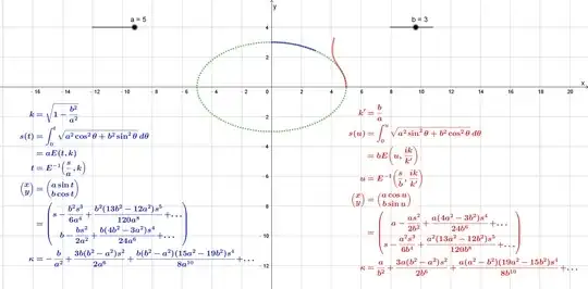

  • Local canonical form starting from minor axis (clockwise convention):
\begin{align} k &= \sqrt{1-\frac{b^2}{a^2}} \\ s(t) &= \int_0^t \sqrt{a^2\cos^2 \theta+b^2\sin^2 \theta} \, d\theta \\ &= aE(t,k) \\ t &= E^{-1} \left( \frac{s}{a},k \right) \\ \begin{pmatrix} x \\ y \end{pmatrix} &= \begin{pmatrix} a\sin t \\ b\cos t \end{pmatrix} \\ &= \begin{pmatrix} s-\frac{b^2 s^3}{6a^4}+\frac{b^2(13b^2-12a^2)s^5}{120a^8}+\ldots \\ b-\frac{b s^2}{2a^2}+\frac{b(4b^2-3a^2)s^4}{24a^6}+\ldots \end{pmatrix} \\ \kappa &= -\frac{b}{a^2}+\frac{3b(b^2-a^2)s^2}{2a^6}+ \frac{b(b^2-a^2)(15a^2-19b^2)s^4}{8a^{10}}+\ldots \\ \end{align}
  • Local canonical form starting from major axis (anti-clockwise convention):
\begin{align} k' &= \frac{b}{a} \\ s(u) &= \int_0^u \sqrt{a^2\sin^2 \theta+b^2\cos^2 \theta} \, d\theta \\ &= bE\left( u,\frac{ik}{k'} \right) \\ u &= E^{-1}\left( \frac{s}{b},\frac{ik}{k'} \right) \\ \begin{pmatrix} x \\ y \end{pmatrix} &= \begin{pmatrix} a\cos u \\ b\sin u \end{pmatrix} \\ &= \begin{pmatrix} a-\frac{a s^2}{2b^2}+\frac{a(4a^2-3b^2)s^4}{24b^6}+\ldots\\ s-\frac{a^2 s^3}{6b^4}+\frac{a^2(13a^2-12b^2)s^5}{120b^8}+\ldots \end{pmatrix} \\ \kappa &= \frac{a}{b^2}+\frac{3a(b^2-a^2)s^2}{2b^6}+ \frac{a(a^2-b^2)(19a^2-15b^2)s^4}{8b^{10}}+\ldots \\ \end{align}
  • Plots of the partial sums for $s\in [0,3]$:
