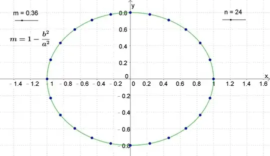

For a small eccentricity $e$,
\begin{align*} e^2 &= 1-\frac{b^2}{a^2}\\ \theta(t) &= t+\left( \frac{e^2}{8}+\frac{e^4}{16}+\frac{71e^6}{2048} \right) \sin 2t+ \left( \frac{5e^4}{256}+\frac{5e^6}{256} \right) \sin 4t+ \frac{29e^6}{6144} \sin 6t+O(e^{8}) \\ \begin{bmatrix} x \\ y \end{bmatrix} &= \begin{bmatrix} a\cos \theta(t) \\ b\sin \theta(t) \end{bmatrix} \end{align*}
the arclength spacing is approximately equal for uniform spacing of $t\in [0,2\pi]$.
See also my newer post here.

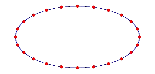

Perhaps the parallelogram method is suited to your purpose? Here it is in action:
(Image by Wikipedia user Cmarm.)
