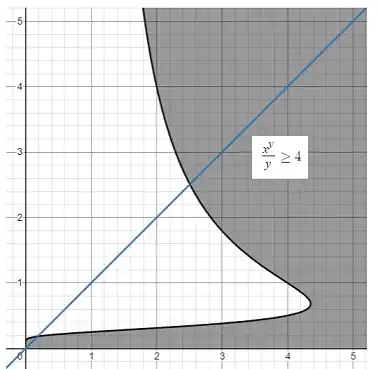

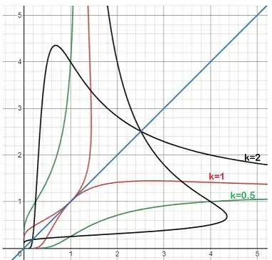

► One has to prove for all point $(a,b)$ of the first quadrant $$f(a,b)+f(b,a)\ge 2$$ ► For all positive value $k$ the curves $f(x,y)=k$ and $f(y,x)=k$ are symmetric respect to the line $y=x$.

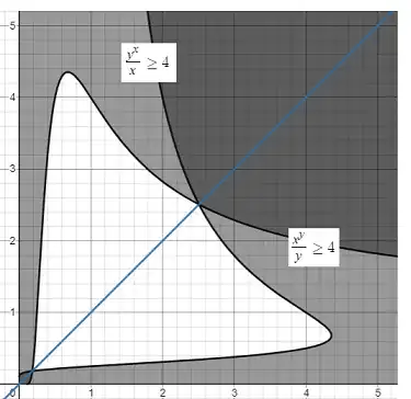

► One can use the black curve above to reduce the problem to prove for the complement of the region defined by $$f(x,y)\ge 2$$ because for any point in the shadow region the proposed inequality is trivially verified (one term of the sum, $f(x,y)$, is already greater than $2$). Note that a neighborhood of $0$ is discarded which is “natural” because a denominator very small is involved.
► Now we can reduce the white region with the symmetric function $f(y,x)=\sqrt{\dfrac{y^x}{x}}=2$ (note for all point $(b,a)$ “above” this curve its symmetric point $(a,b)$ satisfies $f(a,b)\gt2$ so $f(a,b)+f(b,a)\ge 2$).
► So it remains to prove the inequality for the points inside the white region.

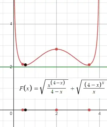

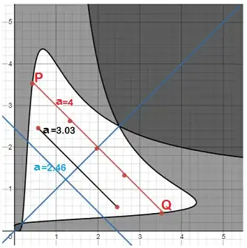

HINT.- Let the line $L: y = -x + a$ where $a$ runs through the interval $[0.36,5.02]$ (these numbers correspond to the values of $a$ for the points of intersection of the two considered symmetric curves). We are going to prove that each point $(a,b)$ of the segment $\overline{PQ}$, where $P$ and $Q$ are the points of intersection of the line with said curves, satisfies the inequality.
For this, let $F$ be the function $$F(x)=\sqrt{\frac{x^{a-x}}{a-x}}+\sqrt{\frac{(a-x)^x}{x}}$$ and study its variation. For example, for $a=4$, if the point $P=(x_0,y_0)$ then $x_0\approx 0.426$ and $F(0.426)\approx2.1247\gt2$ (ideally obviously must be equal to $2$). At the point where $x=y$, when $x=2$ (because of $x=-x+4$) one has $F(2)\approx2.8284\gt2$ and the minimum of $F(x)$is equal to $2.087\gt2$ and the study of the curve can be stop here (by symmetry). Similarly with all other segment with $a\in[0.36,5.02]$ , the problem with $a\ne4$ is analogue. You can verify that for values of $a$ in $[1.77,2.3]$ the minimum of the function $F(x)$ is very near of $2$ but always greater that $2$.
It is clear that you can also calculate the minimum of $F(x)$ for a literal $a$ belonging to the interval above mentioned.
