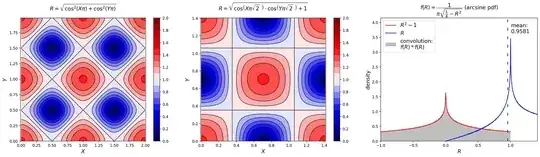

I studied the function of vectorlengths $R$ (left graph picture):
$$R= \sqrt{\cos^2 \left( X \pi \right)+\cos^2 \left( Y \pi \right)}$$
Observations:
  1. When plotting squares can be identified, these form a grid at: $45^{\circ}$. Two distinct shapes (mountains and valleys) can be seen for $R \leq1$ and $R>1$.
  2. The $pdf$ of $R$ (probability density function) is not symmetric and has mean value: $\bar{R}=0.958...$ (solution to integral in question). See right graph picture $pdf$ with blue line.
Next I attempted to find a alternative notation of the function. I rotated the function along the $z$-axis $45^{\circ}$. With help of the matrix (Wiki):
$$\left[ \begin{array}{ccc} \cos \left( \pi/4 \right) & -\sin \left( \pi/4 \right) & 0\\ \sin \left( \pi/4 \right) & \cos \left( \pi/4 \right) & 0\\ 0 & 0 & 1 \end{array} \right]$$
Giving:
$$R'= \sqrt{\cos^2 \left( \frac{1}{\sqrt{2}} \left( X+Y \right) \pi \right) +\cos^2 \left( \frac{1}{\sqrt{2}} \left( Y-X \right) \pi \right) } $$
Note: integral limits change to: $X,Y \in [0,\sqrt{2}]$ forming a symmetric figure (center plot). Using Wolfram Alpha I was able to simplify this function:
$$R'= \sqrt{\cos \left( \sqrt{2} \ X \ \pi \right) \cdot \cos \left( \sqrt{2} \ Y \ \pi \right) +1 } $$
I found that the product: $\cos \left(X \pi \right) \cdot \cos \left( Y \pi \right) $ can be written as a summation: MSE and MSE (when looking at the distribution). So, with $\overset{\mathrm{d}}{=}$ denoting equality in distribution:
$$R^2-1 \overset{\mathrm{d}}{=} \frac{1}{2} \big( \cos(X \pi) +\cos(Y \pi) \big)$$
Resulting in the sum of $arcsine$ distributions both between $R \in [-\frac{1}{2},\frac{1}{2}]$ Wiki:
$$f(R)=\frac{1}{\pi \sqrt{\frac{1}{4}-R^2}}$$
The sum of two $pdf$'s results in their convolution Wiki. Then for two $arcsin$ distributions (not sure if this is allowed):
$$f(R)*f(R)= \int_{-a}^{a} \frac{1}{\pi \sqrt{\frac{1}{4}-\tau^{2}}} \cdot \frac{1}{\pi \sqrt{\frac{1}{4}-(R-\tau)^{2}}} d \tau $$
EDIT: I evaluated this convolution here: SE. The elliptic integral $K$ (complete first kind) occurs for real solutions, just like mentioned in comments. So the distribution becomes: $$\boxed{R^2-1 \overset{\mathrm{d}}{=} \left\lvert \dfrac{2}{\pi^{2} R} \cdot K \left( 1- \dfrac{1}{R^{2}} \right) \right\rvert } $$
The $pdf$ from formula is plotted in right image (gray area). Also plotted is $pdf$ $R^2-1$ directly from data $R$ (red line). The plot has similarities with: MSE. All results seem to match.
OPEN ISSUE: not sure how to convert boxed formula back with $R^2-1$ to asymmetric blue line. But roughly sketched my question is answered.

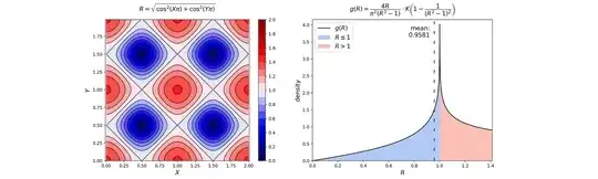

The partial answer I posted showed the $pdf$ (probability density function) of $R^{2}-1$ is equal to:
$$R^2-1 \overset{\mathrm{d}}{=} \left\lvert \dfrac{2}{\pi^{2} R} \cdot K \left( 1- \dfrac{1}{R^{2}} \right) \right\rvert $$
With $\overset{\mathrm{d}}{=}$ denoting equality in distribution, $K$ the complete elliptic integral and $R$ the vector length.
This distribution can be transformed from $R^{2}-1$ to the distribution of $R$, see: MSE. I have little experience in transformation of $pdf$'s. My level is amateur/hobby and do not know the formal notation first, define: $Y=R^{2}-1$ and $dY/dR=2R$.
$$G(Y)=\int_{-1}^{1} \left\lvert \dfrac{2}{\pi^{2} Y} \cdot K \left( 1- \dfrac{1}{Y^{2}} \right) \right\rvert dY =1 $$
$$G(R)=\int_{0}^{\sqrt{2}} \left\lvert \dfrac{4R}{\pi^{2} (R^{2}-1 )} \cdot K \left( 1- \dfrac{1}{(R^{2}-1)^{2}} \right) \right\rvert dR =1 $$
The function within the integral $g(R)$ is plotted and corresponds to observed data.
The question asks the mean vector length $\bar{R}$, the solution to the integral: $$\bar{R}=\int_{0}^{1} \int_{0}^{1} \sqrt{\cos^2(X \pi)+\sin^2(Y \pi)} \ dX \,dY$$
The $pdf$ of the radius $R$ is found as:
$$g(R)= \left\lvert \dfrac{4R}{\pi^{2} (R^{2}-1 )} \cdot K \left( 1- \dfrac{1}{(R^{2}-1)^{2}} \right) \right\rvert $$
The mean value $\bar{R}$ of this $pdf$ is the solution to the following integral (multiply $pdf$ with $R$ and integrate), see Wiki.
$$\boxed{\bar{R}= \int_{0}^{\sqrt{2}} \left\lvert \dfrac{4R^{2}}{\pi^{2} (R^{2}-1 )} \cdot K \left( 1- \dfrac{1}{(R^{2}-1)^{2}} \right) \right\rvert dR }$$
With my available tools I cannot find a nice simple solution. Though integrating $G(R)$ gives a Meijer g function just like mentioned in comments.
When assuming the the red and blue squares (see plot) have the same area I calculated the mean value from both.
$R \in [0,1]$: with mean value $\bar{R}_1=\int_{0}^{1} \left\lvert 2 R \cdot g(R) \right\rvert \ dR$, note: multiply by $2$ to set half area to $1$. Solution with Wolfram alpha online:
integrate 2*4R^2/(pi^2*(R^2-1))*K(1-1/(R^2-1)^2) dR from R=0 to 1
$$\bar{R}_1=0.737076...$$
$R \in [1,\sqrt{2}]$: with mean value $\bar{R}_2=\int_{1}^{\sqrt{2}} 2 R \cdot g(R) \ dR$:
integrate 2*4R^2/(pi^2*(R^2-1))*K(1-1/(R^2-1)^2) dR from R=1 to sqrt(2)
$$\bar{R}_2=1.179107...$$
The mean value: $$\bar{R}=\frac{0.737076...+1.179107...}{2}=0.958092...$$
