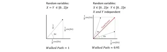

When random variables $X$ and $Y$ are equal $X=Y$ (dependent) then: effective path length is: $1$ else when independent $X \neq Y$: effective path is $~0.96$.

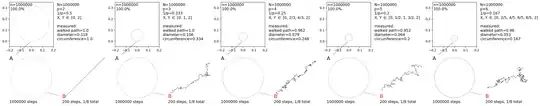

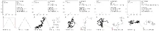

In the GIF below the circles for $p=2$ till $6$ are presented. The random walk consists of $N=1.000.000$ steps, $k$ is listed as natural numbers from: $1$ till $1.000.000$. Every walk is displayed and indexed over $n_{(i)}$.
enter image description here Youtube

The total walked path is $\bar{R}=0.96...$ (from sim.) when random variables $X$ and $Y$ are independent.
$$x(n)=\frac{1}{n} \sum_{k=1}^{n} \cos \left(X \pi \right) \\ y(n)=\frac{1}{n} \sum_{k=1}^{n} \sin \left( Y \pi \right) \tag{1}$$
Effective walked path: $$w=\sum_{k=2}^{n} \sqrt{\Delta x^2_k+\Delta y^2_k}$$
In case $X$ and $Y$ are independent: any vector start in $[0,0]$ and endpoint within the rectangle $x \in [0,1]$ and $y \in [0,1]$ is possible.
When $x$ and $y$ are uniform distributed the average vector length $\bar{R}$ can be calculated:
$$\bar{R}=\frac{1}{a^{2}}\int_{0}^{a} \int_{0}^{a} \sqrt{ x^2+y^2} \ dx dy$$
Where $a$ is the maximum step size single step. For $a=1$ I found a solution with Wolfram Alpha/Python. The total walked path would be $\bar{R}=0.765196...$ in case $x$ and $y$ are uniform distributed.
However: the angles $X$ and $Y$ are uniform distributed and not $x$ and $y$. The integral then converts to:
$$\bar{R}=\int_{0}^{1} \int_{0}^{1} \sqrt{ \cos^{2}(X \pi)+\sin^{2}(Y \pi)} \ dX dY$$
With Python (code below) and Wolfram Alpha a solution is found:
$$\bar{R}=0.958091...$$
This result for $\bar{R}$ is similar as found in simulation rand walk circles in question.
