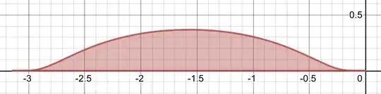

Here is an example area representation of C(e): enter image description here

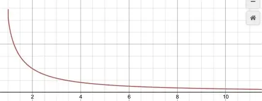

Here is a plot of C(a) with a limit defined maximum at (1,$\pi$) as the integrand for the a=1 case turns, from a limit point of view, into a box like shape with height 1 and length $\pi$. The end behavior is ($\infty$,0) :enter image description here
