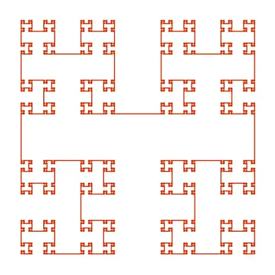

Now, I'll describe the function $g$. This will be done in an inductive fashion using self-similarity. We can set $g=g_0$ where, for each $n\ge0$, $g_n\colon[0,1]\to[0,1]^2$ contains scaled and maybe reflected copies of another such map $g_{n+1}$ in each of the four corner sections $[0,\alpha_n]^2$, $[0,\alpha_n]\times[1-\alpha_n,1]$, $[1-\alpha_n,1]^2$, $[1-\alpha_n,1]\times[0,\alpha_n]$ of the unit square, and follows straight lines in between these regions. This is as in the image below.
smooth curve covering a thin Cantor dust
Let $\theta\colon[0,1]\to[0,1]$ be a smooth function with $\theta(0)=0$, $\theta(1)=1$ and such that its derivatives all vanish at the endpoints. For example, $\theta(x)$ could be taken to be the integral of $\exp(-1/(x(1-x)))$ appropriately scaled. Then, to be precise, we define $g=g_0$ where $g_n=(g_{n,1},g_{n,2})\colon[0,1]\to[0,1]^2$ are defined inductively by $$ g_n(x)=\begin{cases} \alpha_n(g_{n+1,2}(7x),g_{n+1,1}(7x))&{\rm if\ } 0\le x\le 1/7,\\[.3em] (0,\alpha_n+(1-2\alpha_n)\theta(7x-1))&{\rm if\ } 1/7 < x < 2/7,\\[.3em] \alpha_n(g_{n+1,1}(7x-2),g_{n+1,2}(7x-2)-1)+(0,1)&{\rm if\ } 2/7\le x\le 3/7,\\[.3em] (\alpha_n+(1-2\alpha_n)\theta(7x-3),1-\alpha_n)&{\rm if\ } 3/7 < x < 4/7,\\[.3em] \alpha_n(g_{n+1,1}(7x-4)-1,g_{n+1,2}(7x-4)-1)+(1,1)&{\rm if\ } 4/7 \le x \le 5/7,\\[.3em] (1,1-\alpha_n-(1-2\alpha_n)\theta(7x-5))&{\rm if\ } 5/7 < x < 6/7,\\[.3em] \alpha_n(-g_{n+1,2}(7x-6),1-g_{n+1,1}(7x-6))+(1,0)&{\rm if\ } 6/7 \le x \le 1. \end{cases} $$ This does uniquely define $g$. Note that if $\tilde g_n$ was any other sequence of functions to the unit square satisfying the same recurrence equations, then we have $\lVert\tilde g_n - g_n\rVert=\alpha_n\lVert\tilde g_{n+1} - g_{n+1}\rVert$, where $\lVert\cdot\rVert$ is the supremum norm. Also, as they both map into the unit square, $\lVert \tilde g_n-g_n\rVert\le\sqrt{2}$. Putting these together, $$ \lVert\tilde g_n-g_n\rVert\le\alpha_n\alpha_{n+1}\cdots\alpha_{n+r-1}\sqrt{2} $$ for all $r\ge0$. Letting $r$ go to infinity shows that $\tilde g_n=g_n$.
