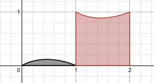

This is about the integral of the inverse gamma function, which is the solution of y to x=y!. This function will be denoted by $y=Π^{-1}(x)$ which is simply x! reflected around y=x. Here is the integral in question when we integrate over its domain. This constant will be denoted by Γ:
$$\mathrm{Γ=\int_{\mathrm{min}(x!),x>0}^1 Π^{-1}(x)dx=1-\int_0^1 x!dx⇔1-Γ=\int_I x! dx}$$
Here is the plot of the wanted figure. The minimum value in the lower bound is very close to $\frac{\sqrt{\pi}}{2}=.886...\ $:a
$$\mathrm{Link!}$$

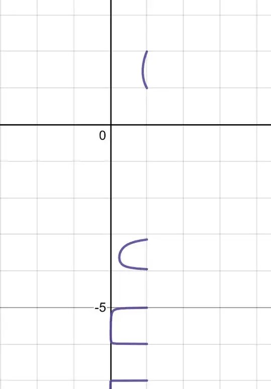

Of course we can just do $$\mathrm{Γ=1-\lim_{x\to \infty}\frac 1x \sum_{n=0}^x\frac nx!=.077254...}$$ for the area of the black figure, which is obvious of how to derive it. Here is what the unmodified area looks like which obviously is unrealistic to integrate: enter image description here
Graph and sum
