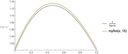

Letting $x!=\Gamma(x+1)$, the Gamma function may be defined through the following limit for an arbitrary $\alpha$ where $x\approx0$ and $x\approx\alpha^2$ for $\alpha\approx1$ are most accurate:
$$x!=\lim_{n\to\infty}\left(n+\alpha\right)^x\prod_{k=1}^n\left(1+\frac xk\right)^{-1}$$
which has simple inverse given by
$$x!^{-1}=\lim_{n\to\infty}\left(n+\alpha\right)^{-x}\prod_{k=1}^n\left(1+\frac xk\right)$$
In the given problem, this leads to an integrand of the form $P(x)\phi^x$ for polynomial $P$ and constant $\phi$, which can be evaluated elementarily.
It's also worth pointing out that refining the estimate by taking larger $n$ does not involve a lot of recalculation since it is just one additional term on the product. However, the convergence is not very fast.
Choosing something such as $\alpha=0.9$ should lead to a good balance of over- and under-estimates of the Gamma function.
This answer is curve fitting, but it involves only 3 parameters. The accuracy is better than 0.13% over all $0<x<1$; good, but nothing like Claude's 8 digits or so. The idea is that the local max is not exactly at 1/2, as implied the factor $x(1-x)$ in Claude's analysis.
$$ \frac{1}{\Gamma(1+x)} \approx 1+ A \ x^b (1-x)^c $$ $$ A=0.538 , \ b=0.971 ,\ c=1.095 $$
The error is close to minimax; that is, the amplitudes of the difference curve are approximately equal.

  • Thanks for answering ! But, as I wrote, I do not want any empirical curve fit. Next, how would you compute the integral $f(t)$ ? "My" maximum is not at $x=1/2$; for the rigorous function, the coordinates of the extremum are $(0.461632145,1.12917389)$ and for the approximation $(0.461632154,1.12917389)$. Cheers and thanks again for the effort. – Claude Leibovici Sep 02 '20 at 04:41
