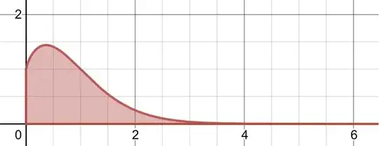

A few years ago, I got interested in an apparently hard integration problem which had me fascinated. This was the integral of a Sophomore Dream like integral except with the bounds over the real positive numbers denoted by $\Bbb R^+$ and not from 0 to 1 over the unit square, or unit line in this case? Nevertheless, this quirky problem caught my attention for having its area be almost 2 with this graph. Here is my solution, although there are a couple of calculations that I could have done differently: enter image description here $$ A\mathit =\mathrm{\int_{\Bbb R^+}x^{-x}dx=\int_0^{\infty}\sum_{n=0}^{\infty}\frac{(-1)^nx^n ln^n(x)}{n!}dx}$$
