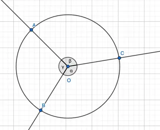

I'm not exactly sure what is $X, Y$. But i assume it's $BA$, $BC$ and $1-X$ is $AB$. $1-Y$ is $CB$, similarly, $|X-Y|$ is $AC$, $1-|X-Y|$ is $CA$.
Given those, the goal is to find a circle with radius $r$ and three points $A, B, C$ on the circle, the minimum interval length is the random variable $M$.
all the intervals
using the same arc length idea. we can simplify this minimum interval problem into the minimum angle.
First, it should be easy to prove. the minimum can't be the sum of two intervals. Namely $M \neq BC+CA, CA+AB, AB+BC$, since some of the $1-?$ is the sum of two other intervals, E.g $1-BA = AC+CB$
We can simplify $M = r*min(\alpha, \beta, \gamma)$, Since $r$ is a constant, we can remove it for easy of analysis.
Also, as $\alpha, \beta, \gamma \sim U(0, 2\pi)$.
$P(min(\alpha, \beta, \gamma) \geq z) = P(\alpha \geq z)P(\beta \geq z)P(\gamma \geq z) = (2\pi-z)^3$
The CDF would be $P(min(\alpha, \beta, \gamma) \leq z) = 1 - P(min(\alpha, \beta, \gamma) \geq z)$
