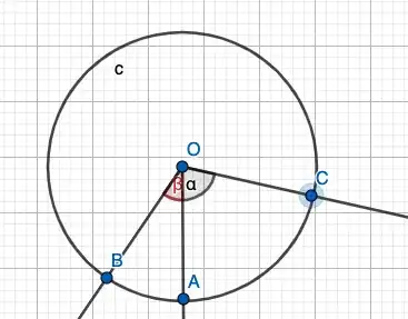

We can introduce an angular representation for $A, B, C$.
Since $A, B, C$ is considered iid. we pick $B$ as the origin for angles.
The distance between $A,B$ would be arc length $r\beta$, where $r$ is 1. Similarly $C,B$ would have length $r \alpha$. As both A, C uniformly distributed. So should both $\alpha, \beta \sim U(0, 2\pi)$.
Now our question is simply asking for the distribution of this random variable $\gamma = min(\alpha, \beta)$.
$P(\gamma > z) = P(min(\alpha, \beta) > z) = P(\alpha > z)P(\beta>z) = (2\pi-z)^2 $
In the end you can change the coordinator back if you want :)
peng yu
  • 1,311
