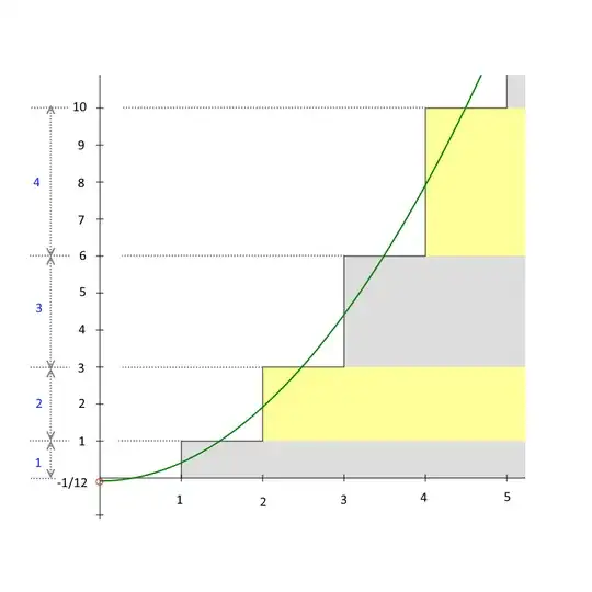

I like this simple graphical explanation.
There are first partial sums of the series 1 + 2 + 3 + 4 + ⋯ on picture. The parabola is their smoothed asymptote; its y-intercept is −1/12.

    I'm afraid I don't follow this at all. – Cheerful Parsnip Sep 11 '15 at 21:02
  • @GrumpyParsnip It's explained at https://en.wikipedia.org/wiki/1_%2B_2_%2B_3_%2B_4_%2B_%E2%8B%AF#Cutoff_regularization . I'm interested in where the version with the labeled axes came from, though. KvanTTT, did you add those yourself? – Chris Culter Sep 13 '15 at 21:01
  • @ChrisCulter, yep, it's my additions. I updated the answer. – Ivan Kochurkin Sep 27 '15 at 18:12
  • How is this smoothing be done? Excel gives me a trendline (polynomial order 2) which passes exactly through zero. – Gottfried Helms Nov 27 '15 at 20:05
  • @GottfriedHelms, I don't know. Probably there is a way to evaluate not only c coefficient (-1/12) of this parabola, but a and b too. It works only with infinite number of points (excel can process only finite set). – Ivan Kochurkin Nov 27 '15 at 23:40
  • Ah, perhaps it is the integral-formula (which leads then to the constant at zero). Ramanujan-summation works with such an integral for the constant term... something like that... – Gottfried Helms Nov 28 '15 at 06:26
    It is somewhat odd that this completely opaque "answer", which the OP themselves concedes they do not know what it means or where it comes from, received 9 upvotes. Maybe for the colors in the picture? – Did Dec 04 '16 at 09:42
    The graph of $y=x^2-\frac18$, which has $y$-axis intercept $-\frac18$, cuts each stage in the middle. If you raise the graph a little bit (by $\frac1{24}$), you can nudge the $y$-axis intercept to $-\frac1{12}$ ; but then the graph intercepts the stages at different (off-centre) places. In your diagram, this is visible on the zeroth stage, where the intercept is at $x=1/\surd6$, and just noticeable on the first stage. – John Bentin Oct 12 '19 at 07:34
