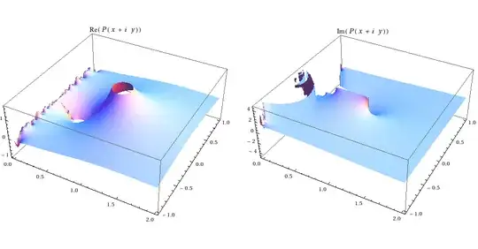

Fröberg shows in his paper that the prime zeta function
$$P(s)=\sum_{p\in \mathbb P} \frac1{p^s}=\sum_{k=1}^\infty \frac{\mu(k)}{k}\log\zeta(ks)$$
where $\mu(k)$ and $\zeta(s)$ are respectively the Möbius and Riemann functions, cannot be analytically continued to the left half-plane, $\Re\,s\leq 0$ (in particular, we cannot give a reasonable evaluation of $P(-1)$), due to the clustering of poles along the imaginary axis arising from the nontrivial zeros of the Riemann $\zeta$ function.
prime zeta plots
Note the nasty-looking left edges in both plots above.
This result is originally due to Landau and Walfisz. See the linked papers for more details.
    Notes: The formula is basically the infinite version of Mobius inversion. And the $P(-1)$ can't be defined because a dense line of poles forms a blockade against any hope of analytic continuation. – anon Nov 22 '11 at 18:20
    Ok, but perhaps there is a different method by means of which it can be done, right? Analytic continuation is only one of many ways to sum divergent series. – Max Lonysa Muller Nov 22 '11 at 18:22
    @J.M.: Here is a short proof: In your formula above, notice that when $s=\frac{1}{k}$ for some squarefree $k$, then we have a $\log\zeta(1)$ term appear in the sum, which means it is a singular point. This sequence $\frac{1}{k}$ for $k$ squarefree is then a sequence of singularities which converges to zero. – Eric Naslund Nov 22 '11 at 18:28
    Also note that this result is originally due to Landau and Walfisz. – Eric Naslund Nov 22 '11 at 18:31

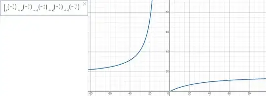

So I received a comment about this on this question. So if its possible to sum the primes using the techniques of that question one strategy would be to extract the $x^1$ term of $\sum_{n=0}^{\infty} e^{p_n x}$ or the $-\frac{1}{x}$ term from the asymptotic expansion of
$$ \sum_{n=0}^{\infty} e^{-\frac{p_n}{x}}$$
So we have that
$$ \sum_{n=0}^{\infty} e^{-\frac{p_n}{x}} = \pi(x) + \frac{1}{2} + ... $$
Where the $\pi(x)$ is a continuous version of the prime counting function (however one can compute that) and $...$ is currently unknown. This result is from a conjectured asymptotic limit. The problem with this formula is that it requires us to define $p_0$ which I don't believe we have a definition for at this time.
I wish had better techniques (or at least A non guess and check technique) for computing these asymptotic series. I think that such numerical techniques exist I just don't know what they are. User 2734364041 outlines a way here to use residue theorems and the mellin transform to get 'closed' forms for these types of sums but I am concerned slightly that using the prime function won't work because of natural boundaries (his Mellin transform ends up yielding a prime zeta function which already one of the answerers here has pointed out sucks)
