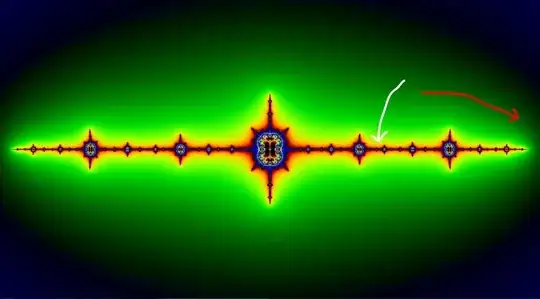

The first image below shows the Julia Set at $-1.749512 + 0i$ (close to the base of the Period-3 Cardioid), and I'd like to find the periodic point located at where the white arrow is pointing at. However, this is my first exposure to Julia Sets beyond the Period-1 Cardioid and the Period-2 Main Disk of the Mandelbrot, and my methods of calculating periodic points don't seem to work here.

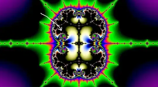

Working off my question here, I concluded that I needed to use $\frac{1 - \sqrt{1 - 4c}}{2}$ to find the desired point - and this worked as intended for all Julia Sets close to the Period-1 and 2 components of the Mandelbrot. Applying that to this Julia Set, however, centers at the white arrow in the second image (I understand why this is, but I don't know how to work around it).
I also tried using the following formula for finding pre-images of periodic points (which I learned from this question), but the found point never falls on the center, regardless of the combination of pluses and minuses I use...
$$z_{-1}^*(t)=\pm\sqrt{z_0^*(t)-c(t)}=\pm\sqrt{\frac{1\mp\sqrt{1-4c(t)}}{2}-c(t)}$$

    The periodic points are dense in the Julia set; indeed, one may characterize the Julia set as the closure of the set of repelling periodic points. Thus, you can't simply draw an arrow and expect to uniquely determine a periodic point. If you're looking for an attractive periodic point, you can simply iterate from zero until you detect convergence. I don't know that this particular function has any, though. For other types of periodic points, you might try to solve an equation of the form $f_c^n(z)=z$. – Mark McClure Jul 21 '20 at 12:12
  • This is so cool, thank you for sharing this question. – Taylor Rendon Jul 21 '20 at 16:08
  • @MarkMcClure I don't think simply iterating z will work here, this is a period-3 Julia Set so there would be 3 attractive points... I wished I had more knowledge regarding periodic points, I feel like there's a lot I can still learn. – Ibrahim Mahmoud Jul 21 '20 at 20:26
  • @MarkMcClure I just tried that idea anyways, but none of the 3 attractive points actually get me to the point I'm looking for in this Julia Set (they're all on the x-axis, where the point I'm after is slightly above it). I'm pretty sure that's because this Julia Set is disconnected, and if it was filled then it would have worked. – Ibrahim Mahmoud Jul 25 '20 at 00:44
  • The Julia set that you have drawn appears to be the Julia set for $c=\color{red}-1.749512$, which is definitely connected and (as far as I can tell) has no attractive orbit. Your value of $c=\color{red}+1.749512$ as stated in the problem is certainly totally disconnected and has no attractive orbits. When you write "3 attractive points", perhaps you mean attractive orbit of period 3? A quadratic can have at most one attractive orbit, though you can arrange for the period of that orbit to be anything you want. The quadratic will always have infinitely many repelling periodic orbits. – Mark McClure Jul 25 '20 at 12:01
  • @MarkMcClure Oh yes you're right, thank you for noticing that I fixed it in the question. Yes I did mean attractive orbit of period 3 - I was referring to the 3 periodic points that the orbit is supposed to oscillate between (in filled Julia Sets). Nevertheless, I edited my question to clarify what kind of effect I'm after (I strongly suspect that the desired point is the solution to $z_{p+1}=z_p^2+c$ where $p$ is $2$) – Ibrahim Mahmoud Jul 26 '20 at 01:26
