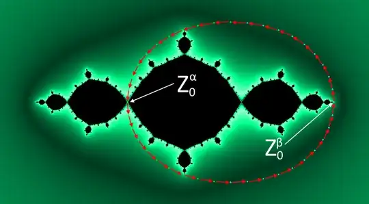

The fixed point pair are given by $$z_0^*(c)=\frac{1\mp \sqrt{1-4c}}{2}, z_0^{*\alpha}(c)\equiv\frac{1-\sqrt{1-4c}}{2},z_0^{*\beta}(c)\equiv\frac{1+\sqrt{1-4c}}{2}$$ (I use $\mp$ becuase the alpha fixed point is the negative and the beta is the positive.)
I have noticed that the fixed points transform smoothly from their "alpha" fixed point to their equivalent "beta" fixed point (and vice-versa) after a full $2\pi$ rotation of $c$ about the origin, essentially permuting the roots. Generally, I keep $r=1$ and explore the unit circle. Therefore, I can use the Julia set known as the "Basilica" corresponding to $c=-1, (t=\pi)$ as a standard set or start/finish point when watching the fixed points transform through a full rotation. I choose this particular value/set because it's easiest (visually, I think) to see the relationship of the 2 fixed points and their preimages to the basins of attraction (at least, when $J_c$ is connected).
For example, the alpha fixed point (of $c=-1$) is the "pinch" (labeled $Z_0^\alpha$ in the picture) between the root basin and the period-2 basin to the left equal to $$z_0^{*\alpha}(-1)=\frac{1-\sqrt{1-4(-1)}}{2}=\frac{1-\sqrt{5}}{2}$$
and the beta fixed point is the far end of the set on the real axis (labeled $Z_0^{\beta}$ in the picture and is furthest right) $$z_0^{*\beta}(-1)=\frac{1+\sqrt{5}}{2}$$
and is basically a limit point. I consider it a limit-point in the sense that it falls at the end of a limit sequence of basins, whereas the alpha fixed point is the point between the 2 largest basins (For reasons of left-right symmetry, only looking at $\Re (z)<0$). The beta fixed point seems to be the equivalent of an infinitesimal for fixed points. All the other "pinch" points are preimages of the alpha fixed point (points labeled $Z_n^\alpha$ in image, plus more) and all of the other limit-points at the end of every limit-sequence of basins are preimages of the beta fixed point (points labled $Z_n^\beta$, plus more).
So when $t\to 2\pi n, n\in\Bbb{Z},n>0$, (one or more full rotations back to $c=r,t=0\mod 2\pi$), $$\lim_{t\to2\pi n}z_0^{*\alpha}(c(t))=z_0^{*\beta}(c(0)), \lim_{t\to2\pi n}z_0^{*\beta}(c(t))=z_0^{*\alpha}(c(0))$$
but there is a discontinuity in the equation at $t=2\pi n,n>0$ where the signs flip and $z^{*\alpha}$ and $z^{*\beta}$ go back to their original values. So if I'm watching the alpha fixed point and, right at the point of the sign change, I swap to watching the beta fixed point (and vice-versa after another $2\pi$), a continuous periodic curve (very, very close to but not exactly an ellipse) can be traced out with a period of $4\pi$ returning the "original" fixed points (when $t=0$) back to where they started.
(YouTube - Path Traced By Fixed Points)

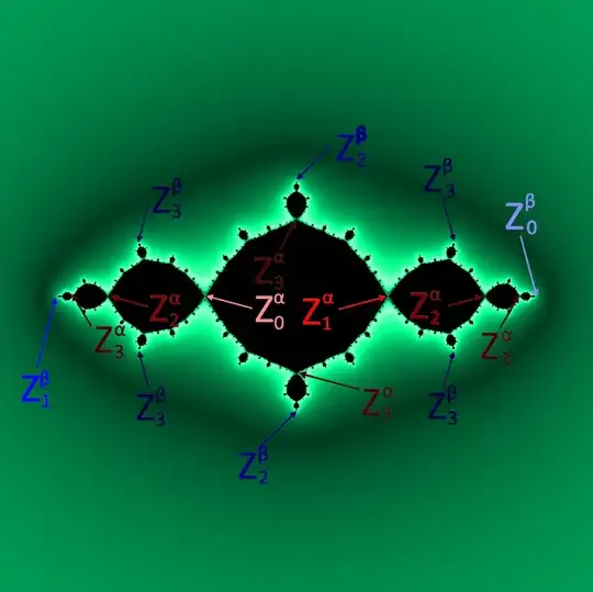

A "big" fixed-point (alpha-like, $Z_n^\alpha$) becomes a "small", or infinitesimal, fixed point (beta-like, limit-sequence, $Z_n^\beta$) and so on. The preimages of the fixed points behave similarily, alternating between alpha-like and beta-like every rotation.

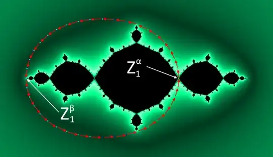

Preimages of the fixed points are given by $z_{-(n+1)}=\pm\sqrt{z_{-n}-c}$ so the primary preimages are given by $$z_{-1}^*(t)=\pm\sqrt{z_0^*(t)-c(t)}=\pm\sqrt{\frac{1\mp\sqrt{1-4c(t)}}{2}-c(t)}$$
When this function is traced out, it creates the exact same shape as the fixed points themselves, only translated left, swapping between the first "pinch" point to the right of the main basin ($Z_1^\alpha$) and the far left limit point on the real axis ($Z_1^\beta$, far left).
(YouTube - Path Traced By Primary Preimages of Fixed Points)

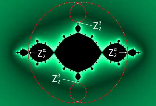

Secondary preimages, given by $$z_{-2}^*(t)=\pm\sqrt{\pm\sqrt{\frac{1\mp\sqrt{1-4c(t)}}{2}-c(t)}-c(t)}$$ however, make a very different shape when traced out. There are four (unique) preimages for $n=-2$. There are two "big" or alpha-like preimages (labeled $Z_2^\alpha$) and two infinitesimal or beta-like preimages (labeled $Z_2^\beta$). These four fixed points also smoothly transform between each other over the course of a rotation of $2\pi$, except because there are four of them, they cycle between four positions every $2\pi$ and they require not $4\pi$ (or two rotations) to return to their original position (like the $0^{th}$ and $1^{st}$ preimages) but $8\pi$ (or four rotations) to return to their original position.
However, just like the other fixed points and preimages, they alternate every $2\pi$ between an alpha-like (or "big") fixed point and a beta-like (or infinitesimal) fixed point. A rotation of $2\pi$ essentially permutes all of the preimages of a given level of the fixed points while a rotation of $4\pi$ permutes the alpha-like fixed points separately from the beta-like fixed points. But the curve traced out by such a transformation is not a simple circle- or ellipse-like figure, but a slightly more complicated shape, shown in the diagram below:
(YouTube - Path Traced By Secondary Preimages of Fixed Points)

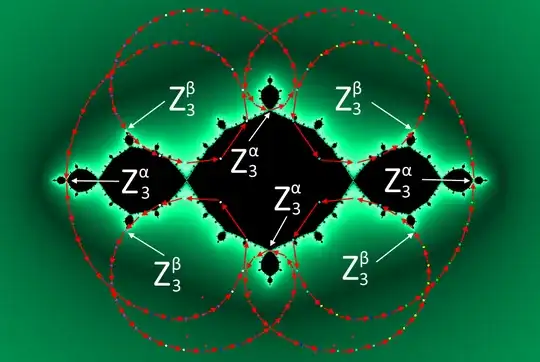

Tertiary preimages, of which there are 8 unique roots, permute between the four alpha preimages (labeled $Z_3^\alpha$) and the four beta preimages (labeled $Z_3^\beta$). That function, when traced out, leaves another strange curve:
(YouTube - Path Traced By Tertiary Preimages of Fixed Points)
