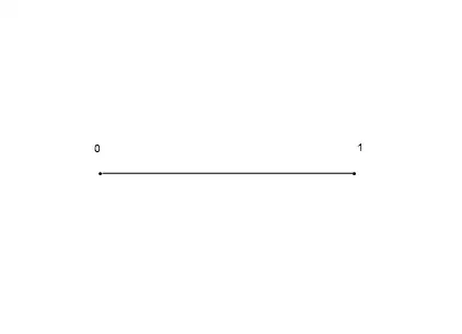

The simplex $\Delta_1$
has one-dimensional volume, i.e., length $=1=\frac{1}{1!}$.

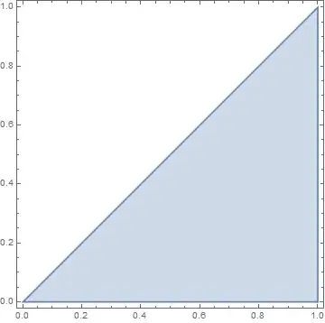

The simplex $\Delta_2$
has two-dimensional volume, i.e., area $=\frac{1}{2}=\frac{1}{2!}$.

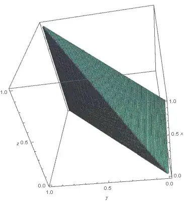

The simplex $\Delta_3$
has three-dimensional volume, i.e., just volume $=\frac{1}{6}=\frac{1}{3!}$.

    I was just about to add a picture showing how a cube is split into six identical simplices by the planes $x=y$, $y=z$ and $z=x$. But then you had already added pictures, so I guess that would be pointless. Anyway, thanks for a nice answer as well as doing your best visualizing it :-) – Jyrki Lahtonen Jul 31 '20 at 14:22
  • @JyrkiLahtonen: Thanks. What would be best would be an animation where the six identical pieces would be moved around and recombined into the unit cube. However, this is way beyond my current skills. – Abdelmalek Abdesselam Jul 31 '20 at 17:44
  • I think one half of them are mirror images of the other half, so they cannot be shown as rotated copies of the same piece. I am practicing animations with Mathematica (for fun as well as for educational material), so I might give it a try. – Jyrki Lahtonen Jul 31 '20 at 18:29
  • Too late an hour. FWIW the next to last picture here shows all eight octants split into six simplices like here. – Jyrki Lahtonen Jul 31 '20 at 21:30
  • @JyrkiLahtonen: You are correct of course. One needs three identical pieces and three mirror images, which reflects the sign of the six permutations. – Abdelmalek Abdesselam Aug 03 '20 at 17:32
