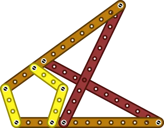

One of the given constructions is a rigid pentagon with just two extra sticks. However, it does not look very nice because it requires long extensions of two sides.
Extend two non-adjacent sides of a pentagon with unit side length to 4 times the original width. Then you can fit two sticks of length 11/3 between them

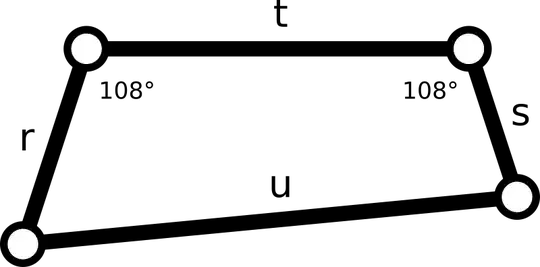

So I decided to make it less intrusive (in the sense of "less occupied space outside the pentagon") as follows. Let $r,t,s$ be the lengths of three consecutive sides of a quadrilateral, with $108^\circ=\frac{3\pi}5$ angles between them:
Then it is easy to show that the fourth side length $u$ is $$\sqrt{\left((r+s)\cos\frac{2\pi}5+t\right)^2+\left((r-s)\sin\frac{2\pi}5\right)^2}$$ We want all four side lengths to be rational (but they can be negative). If $u$ is rational, so is $u^2$, so the expression inside the square root must also be rational. Expanding it gives $$r^2+s^2+t^2-\frac{rs+rt+st}2+\frac{\sqrt5}2(rt+st-rs)$$ and for this to be rational we must have $rt+st-rs=0$ or $t=\frac{rs}{r+s}$. Making this substitution gives $$u=\sqrt{\frac{r^4+r^3s+r^2s^2+rs^3+s^4}{r^2+2rs+s^2}}$$ Clearly we can scale any solution $(r,s,t,u)$ by any rational number, so we set $r=1$ arbitrarily: $$u=\sqrt{\frac{s^4+s^3+s^2+s+1}{s^2+2s+1}}=\frac{\sqrt{s^4+s^3+s^2+s+1}}{|s+1|}$$ Thus, up to scale, all rational solutions correspond one-to-one with solutions of $$s^4+s^3+s^2+s+1=y^2\qquad s,y\in\mathbb Q,s\not\in\{0,-1\}\tag1$$ The same equation has been posed on this site before, but only with integers, and I could not find any good reference in this answer. By Faltings's theorem there are only finitely many solutions, but have I found all of them?

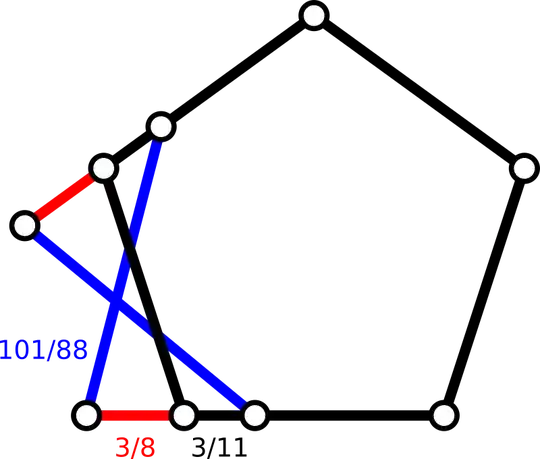

The solution with $s=-\frac{11}8$ in particular gives a much less intrusive rigid pentagon. (All black sticks below, sides of the pentagon, are of unit length.)
extend by 3/8, then fit two sticks of length 101/88
