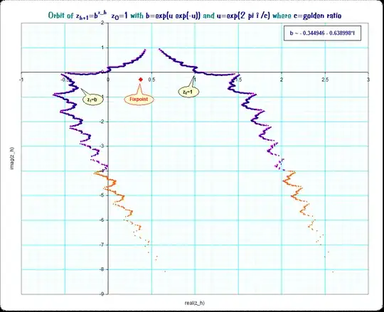

The found pictures gave an interesting variety of pictures of the orbits depending on the above classification.

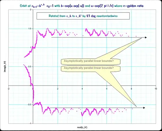

Now towards my question: The picture using that $c= \small "golden-ratio"$ shows a pattern which suggests two parallel orientations in that orbit, which I didn't observe in the other above classes. Usually the orbits for the irrational bases look more like some closed star-form shape with fractional borders and excurses "towards infinity", but here I find a somehow "most simple" shape.
It is much time-consuming to compute the orbit to millions or billions iterations, but I did a fairly usable list of that iterations ($1e8$). The indication of that parallel orientations becomes even stronger with longer orbit.
a) Can we prove, that the continuation of the orbit fills out the pattern so far, such that we have that two partial orbits along two parallel directions?
b) What might be the reason for this remarkable shape?

here is a rotated image to help the intuition for the a)-question:

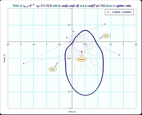

Update: It might be interesting (and possibly helpful to avoid misleading ideas) to see, that selecting a different startvalue $z_0$ can lead to an asymptotically closed(?) (and dense?) curve. I used $z_0=1.1+0.1I$ finding that initial orbit for the first $2000$ iterations:
To see the initial behave the first $20$ or so iterates are connected by the thin grey line and have an additional frame around the dots.
    cool stuff; if c is a well behaved irrational number like the golden ratio, or $\sqrt{2}$ then the iteration is unbounded.... These rotation numbers have a defined $\Psi$ Schroeder function where as the rational values don't. One can compare to iterating simpler equations like $z \mapsto \lambda z + z^2;;;;$ $\lambda=\exp(\frac{2\pi i}{c})$. https://en.wikipedia.org/wiki/Jean-Christophe_Yoccoz was awarded a fields medal for studying this non-trivial problem. https://en.wikipedia.org/wiki/Brjuno_number – Sheldon L Aug 15 '19 at 11:43
    Another relevant link is the https://en.wikipedia.org/wiki/Siegel_disc (time is limited). The Siegel_disc for the iterated exponential is unbounded.... – Sheldon L Aug 15 '19 at 12:11
    Hi Sheldon, thanks for the links! At "unboundedness": well, if $c$ is irrational and the orbit passes $0 \to 1 \to b \to b^b \to \cdots$ then the mechanics of the continued fractions (here of $c$) govern, that high-index iterates appear near and nearer to any earlier iterates. This is of course true for $z_{-1}=0$ and even more significant for $z_{-2} = \log_b(0) \to \infty$ So there are infinitely iteration-indexes $h$ coming near-and-nearer towards $\infty$ , towards $0$ etc. So any orbit of this type should be unbounded... – Gottfried Helms Aug 15 '19 at 12:15

  • I generated the formal series for the inverse Schroder function for your base and I'm trying to match your third plot with $z_0=1.1+0.1i$, but I think maybe you actually used $z_0=1.0-0.1i$ for your third plot? My plot for the formal analytic inverse schroder function is very close to your 3rd plot using $z_0=1.0-0.1i$. – Sheldon L Aug 16 '19 at 08:43
  • The exactness of the $z_0$ initial value seems not to be essential. I just looked for instance for starting values nearer to the real line, just by taking mean value of two near iterates as new $z_0$ - it was surprisingly robust: all tried $z_0$ ran into one stable "closed curve" of roughly egg shape; for instance I took $z_0 = 0.926966+0.0 î$ which is nearly on the egg-shape interpolated (or asymptotically dense?) curve. If something still is unsatisfactory, please write again here. – Gottfried Helms Aug 16 '19 at 09:43
  • @SheldonL - ah, I think I got it. I guess your value $z_0=1.0-0.1î$ seems to be one dot already *on* the curve in my third plot. My own initial $z_0=1.1+0.1î$ is off the curve but iterations from there converge to that curve nonetheless. So maybe the Schroeder-function does not work well with points off the curve. (remark: I've earlier introduced the term "equator" for that non-contracting, non-diverging orbits which seem to form dense curves when iterations go to infinite height. Perhaps that term "equator" is a good choice and could be used for that phenomenon) – Gottfried Helms Aug 16 '19 at 09:49
  • @SheldonL - I've reproduced the Schröder-function approach and indeed $z_0=1.1+0.1î$ is not a good parameter for the function. But iterating it $11$ or $18$ times makes it a nicer argument for the Schröder-powerseries... – Gottfried Helms Aug 16 '19 at 10:08

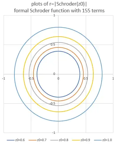

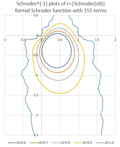

The Op's base is base b. $$\phi=\frac{\sqrt{5}+1}{2};\;\;\;\;\lambda=\exp\left(\frac{2\pi i}{\phi}\right)\;\;\;$$ $$b=\exp\left(\lambda\exp(-\lambda)\right);\;\;\;l=\exp(\lambda);\;\;\;l=b^L$$ The derivative at the fixed point is $\lambda$ since $\exp_b(l+x)=l+\lambda x + O(x^2)$. I generated the formal Schroder function $\Psi$ at the fixed point of l such that: $$\Psi(b^z)=\lambda\Psi(z)$$
Then I generated $\Psi(0.6,0.7,0.8,0.9,1.0)$ which matches the Op's previous plots at 0.7 and 0.8. I actually used $\Psi^{-1}$ and Newton's method for the inversion. For the plots below, a 155 term Schroder function Taylor series for $\Psi^{-1}$ is accurate to
  • 38 decimal digits for $|\Psi(0.6)|$
  • 30 digits for $|\Psi(0.8)|$; 18 digits for $|\Psi(0.9)|$
  • 1.5 to 3 digits for $|\Psi(1.0)|$
You get the analytic limit for the fractal by starting with the singularity at $\Psi(0)$ or $\Psi(1)$ so the Schroeder function isn't that accurate, but it made a cool plot and I was surprised how well the $\Psi^{-1}$ Taylor series modeled the fractal boundary for $\Psi(1)$. For the other cases $\Psi(z_0)$ initial values, $\Psi^{-1}$ works extremely well. Gottfried's iterated sequences are equivalent to formally iterating:
$$z_n=\exp_b(z_{n-1});\;\;\;z_n=\exp_b^{[\circ n]}(z_0);\;\;\;\Psi(z_n)=\lambda^n\Psi(z_0)$$ $$z_n = \Psi^{-1}(\lambda^n\Psi(z_0));\;\;\;$$
Since the limit of the set of points mapped by iterating $z\mapsto \lambda z$ is the unit circle, then the limit of the iterating sequence is formally equivalent to plotting the points mapped from a circle that has a radius of the absolute value of $|\Psi(z_0)|$ $$\Psi^{-1}(|\Psi(z_0)|)$$ enter image description here
The Op asks, "I have been interested in the reason for the difference between rational and irrational c in this problem and looked at graphs of the orbit". Since the infinite continued fraction representation of c, where $\lambda=\exp(\frac{2\pi i}{c})$ effects how smoothly the mapping of $\lambda^n$ fills in the unit circle, it effects how nicely the Schroder function behaves and whether it converges or not. If c is rational, the Schroder function does not converge. That is why a lot of these Siegel disc plots use $c=\phi$; the golden ratio, since it has an ideally behaved continued fraction representation.
The fractal structure is governed by the logarithmic singularity of 0, as the Op noted in the discussion: "...if c is irrational and the orbit passes $0 \mapsto 1 \mapsto b \mapsto b^b ...$ then the mechanics of the continued fraction (here of c) govern that high-index iterate appear nearer and nearer to any earlier iterates. This is of course true for $z_1=0$ and even more significant for $z_0=\log_b(0) \to \infty$. So there are infinitely iteration indexes h coming nearer-and-nearer towards $\infty$...."
The proof of the convergence properties based on the multiplier at fixed point was given by http://en.wikipedia.org/wiki/Jean-Christophe_Yoccoz who was awarded a fields medal for studying this non-trivial problem. See also http://en.wikipedia.org/wiki/Brjuno_number
The Op's initial fractal plot is a plot of the Siegel disc, which is the fractal limit of the convergence of the $\Psi^{-1}(z)$ function. http://en.wikipedia.org/wiki/Siegel_disc

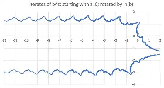

Here is one more picture, showing the iterates of $z \mapsto b^z$ starting with $z_0=0$; and then multiplying each point $z \cdot \log(b)$, so that the logarithmic singularity goes to negative infinity for $\log(z)$ where z is in the neighborhood of zero; as expected. Here the vetical part of the logarithmic singularity covers a little more the $\pi i$ which also makes sense. enter image description here

  • Hi Sheldon, this is again a treasure of thoughts and comments leading forward. Thanks very much! I'll need a bit to metabolize all. Just a small comment. For the initial value $z_0=1.0$ it would be better the curve were not connected. It seems it is infinitely often open at the curvy excesses in your picture. I looked at the area of the $h=514233$'th iterate which is about $-0.674467 - 0.881450$ and with its neighbours of further and backwards iterates in steps taken from the cf-convergents (for instance $h+=121393$ or $h+=514229$ or so) it looks still spiky with an always open gap outwards. – Gottfried Helms Aug 17 '19 at 03:15
    @gottfried agreed; its an open curve with open gaps. My graph starting with $z_0=1$ was over the Schroder function approximation with 155 Taylor series terms, not of the iterates themselves, so it is a continuous, but only an "approximation". – Sheldon L Aug 17 '19 at 03:19
  • Perhaps mention explicitely in the post? – Gottfried Helms Aug 17 '19 at 03:22
  • "singularity at .. $\Psi(1)$ so the Schroeder function isn't that accurate, but it made a cool plot ..." I was actually surprised by how well the Schroeder function Taylor series modeled the fractal singularity. – Sheldon L Aug 17 '19 at 03:24
  • Ah, and I should look also at Yoccoz' work to find a more general field of an answer to my questions a) and b) ... That would make your post the accepted one... – Gottfried Helms Aug 17 '19 at 03:25
  • ... at $\Psi(1)$ - well indeed it makes a cool plot! – Gottfried Helms Aug 17 '19 at 03:26

  • I have one more plot I didn't post of the iterates of $z \mapsto b^z$ and then plotting $z\dot\ln(b)$. There the logarithmic singularity very clearly goes to negative infinity as expected for log(z) near z=0., It looks like a little more than $\pi i$ in the vertical direction plus lots of other copies the singularity along the branch to minus infinity. Adding the picture now ... – Sheldon L Aug 17 '19 at 03:38
  • Yes, that rotation-plot looks very good. I'll try to reproduce your ideas from the start again, but need sleep now. I'll try also the Newton-algo for to compute the $\Psi()$ from the $\Psi^{-1}()$ (I've always enhanced the range of convergence of the $\Psi()$ using Euler-summation on the non-converging series (but which has its limits, seemingly especially in this case). I'll return to this tomorrow. Thanks so far! – Gottfried Helms Aug 17 '19 at 03:50

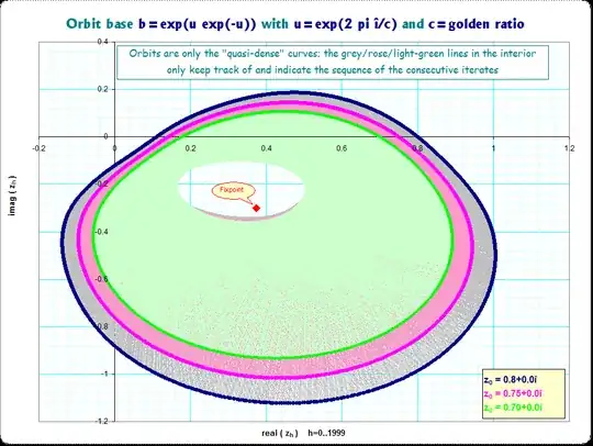

this is not an answer but only an extended comment detailing one aspect of the effect shown in the third picture

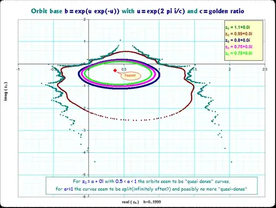

For the subject of initial values $z_0$ thrown in the comments of @SheldonL I show a composite picture made from three $z_0$ on the real line between $0$ and $1$.
Surprisingly each of three rather randomly chosen initial values produced its own shape ("equator") which does not change its visual image when iterated further but only fills the circumference of the shape/"quasi-dense curve" more densely.
It's worth to remark that when $z_0$ taken from some random value, say $z_0=1.5+1.3 î$ then this orbits even into a finite period of $3$ accumulation/periodic points - so that observation of "quasi-dense equators" (so-to-say) is not a general effect of this type of infinite iteration. The following picture shows the image for $z_0=1.1$ to give a bit more context:
