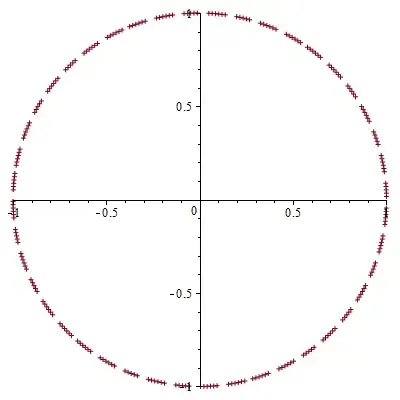

Let me try to explain what happens with these sequences using a simpler example. Modulo the magnitude of the complex numbers they shuffle, they are almost identical behaviorally to the sequence $a_n=\exp(i n)$, $n\in \mathbb{N}$, for example. Let's see that sequence on the complex plane for say, $N=250$.
restart;
with(plots);
a := proc (n) options operator, arrow; exp(I*n) end proc
N:=250;
L1 := [seq([evalf(Re(a(n))), evalf(Im(a(n)))], n = 1 .. N)]
plot(L1, style = point, symbol = cross, scaling = constrained)
This sequence is dense on the unit circle. It is an iterated rotation with angles which are irrational multiples of whatever unit angle you use. Accordingly, their projections, $\Re(a_n)$ and $\Im(a_n)$ are dense in their corresponding intervals, $[-1,1]$ and $[-i,i]$. These are standard results which you can find in this forum, on the question "does $\sin(n)$ converge", etc.
So the above sequence, is afortiori divergent, using your favorite catchall for any non-convergent sequence.

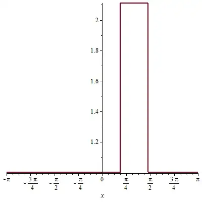

Suppose then that we generate additionally a unit impulse along the direction of the angle $\theta=\pi/3$. Here's the corresponding impulse:
r := proc (x, epsilon) options operator, arrow;
piecewise((1/3)*Pi-(1/2)*epsilon < x
and x < (1/3)*Pi+(1/2)*epsilon, 1+1/epsilon, 1) end proc
plot(r(x, .9), x = -Pi .. Pi)

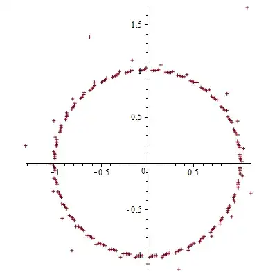

Now, let's see the corresponding distribution for the sequence $a_n$:
L2 := [seq([evalf(Re(r(.9, n)*a(n))), evalf(Im(r(.9, n)*a(n)))],
n = 1 .. N)];
plot(L2, style = point, symbol = cross, scaling = constrained);
You can easily verify now, that the sequence has acquired some local "fuzz", with several elements sling-shot to farther values. Now, if you turn the fuzz into locations, by using the option of line-connect on the graph, you will see the overall momentum of the distribution, which is something like this:
plot(L2, style = line, scaling = constrained)
It is fairly clear now, that the momentum "tends" to blow the orbits away. The total trajectory then, can be used to find bounds for the domain of the sequence. In fact, the Fatou domain of the iteration, is determined precisely by the Convex-hull of the above figure (which is symmetric with respect to the axis $0$-farthest point.

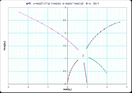

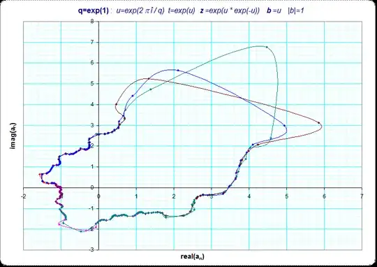

Case 1) As Yiannis Galidakis has already pointed out, in the case 1) (where $q \in \mathbb Q$) we'll have convergence (different from the assumption in the OP's question - and also from an earlier answer of myself, in which I suggested non-convergence); two numerical examples suggest that by visual inspection and where the numerical errors also seem to be neglectable.
The first picture shows the orbit for $q=5$ beginning at $a_0=z=1$ giving a five-edge-star contracting along with the iterations. To see the effect of the contraction clearer I connected each fifth iteration with lines and get this way five separated curves (call them "partial orbit"), each one approximating a/the fixpoint $t_5$ in the middle which can be found numerically using Newton-iteration or using the Lambert-W-formula and setting $t=\exp(u)=\exp(-b)$
img_5

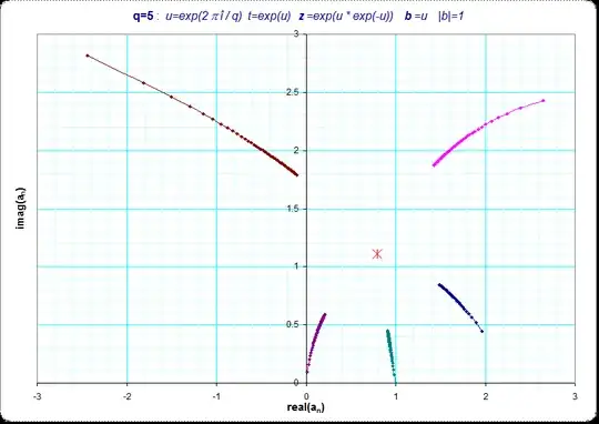

However, the rate of contraction seems to diminuish and by visual inspection only this might possibly get stuck in 5 periodic accumulation points.
Thus I've prepared another picture, where the numbers of iterations per documentation in the curves increase with the powers of 2, so the first round of 5 iterations begin at $a_0$, then the next round at $a_10$, next $a_{20}$, $a_{40}$,$a_{80}$,...,$a_{10240}$... Now we see the contracting effect again, but still with some diminuishing rate:
img_5_progr

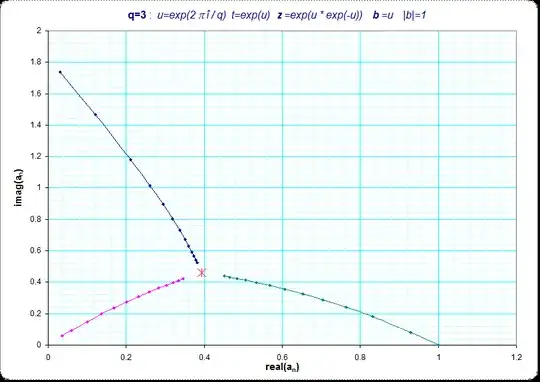

It is similar with $q=3$ (so $b$ is the 3'rd complex unit-root) giving an orbit with three partial curves, apparently contracting to the fixpoint $t_3$. As before, the number of iterations documented by dots was increased by increasing powers of 2 to focus the general tendency:

Case 2) While the two examples with rational $q$ give clear images with $q$ partial curves, in the case 2) selection of irrational $q$ give more irregular orbits without (so far) discernable contraction or expansion. Instead, when iterating the orbit seems to fill out some curve with fractal border but with a possibly meaningful smooth interpolation in most regions. Periodicity means here, that with a numbers $r$ of steps the points $a_n$ and $a_{n+r}$ are near, and the nearness can be made arbitrarily small by using $r$ from appropriate convergents from the continued fraction of $q$. So with $q=\exp(1)$ I found a nice value for $r=87$ giving the following image, consisting of $r$ partial orbits:
(Remark: the following pictures were computed by shifting the fixpoint to the origin, which also means to use $d_{n+1} = t^{d_n}-1$ instead of $a_{n+1}=z^{a_n}$. The shape of the curve is only marginally affected)
img_exp
The different colors of the lines mark different partial orbits (only a couple of them are shown). I did not discover contraction or expansion of the interpolation-curve so far; also in the top-right region there might be a singularity - but I've not done enough iterations to see this clearer.

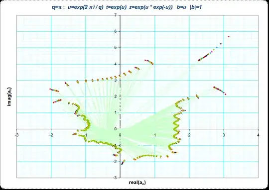

An artistic looking image give the value $q=\pi$. Here I did separation of the orbit into 11 partial orbits, and to declutter the image I only show one partial orbit connected by a line.
img_pi
Separation into 355 partial orbits, btw., gives very dense partial orbits, but I did not yet produce a visual more satisfying image with this option.
