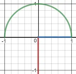

$$a\uparrow\uparrow b=\begin{cases}a^b,&b\in[0,1]\\a^{a\uparrow\uparrow(b-1)},&b\in(1,+\infty)\\\log_a(a\uparrow\uparrow(b+1)),&b\in(-\infty,0)\end{cases}$$

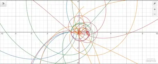

Combining this with my old question, I made the following graph of $i\uparrow\uparrow x$ for $x\in(-2,9)$, using $z=re^{i\theta},\theta\in[0,2\pi)$:
(x-axis is the real axis and y-axis is the imaginary axis)
Is there anything special to be said about this?
About how each look always connects to the previous 'branch' and then steps off the branch until it hits the next one. Can we prove this is indeed the case?
Prove or disprove that the tangent line at each interception is equivalent for the original branch and the branch coming out that heads towards the center.
It also appears the branches connect perpendicularly.
Are these shapes similar to one another?
The pattern is rather intriguing, don't you think?

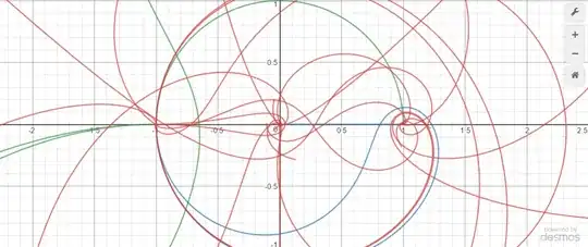

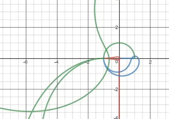

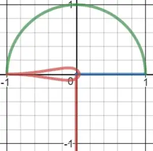

It appears $(-1)\uparrow\uparrow x$ is likewise interesting to look at:
Link to graph.
It starts off how one might expect it to start off:
It makes a loop:
Then another loop:

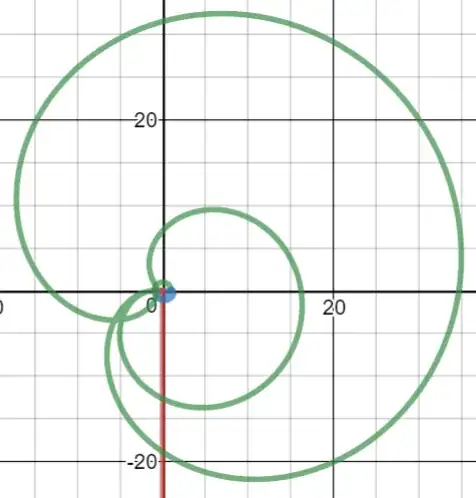

And then it blows up into a circular shape that reaches about 35 units away from the origin:
Closer image:

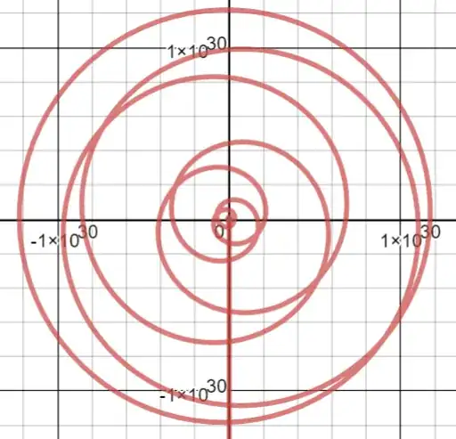

And then it goes on past $10^{30}$:
Closer image:
Medium zoom:
Another loop:
Any explanation for why this is so much more 'chaotic' than $i\uparrow\uparrow x$? Perhaps we can define chaotic or not as follows:
\begin{align}\lim_{x\to\infty}a\uparrow\uparrow x\ \text{converges}\implies\text{stable/non-chaotic}\end{align}
\begin{align}\lim_{x\to\infty}a\uparrow\uparrow x\ \text{diverges}\implies\text{unstable/chaotic}\end{align}

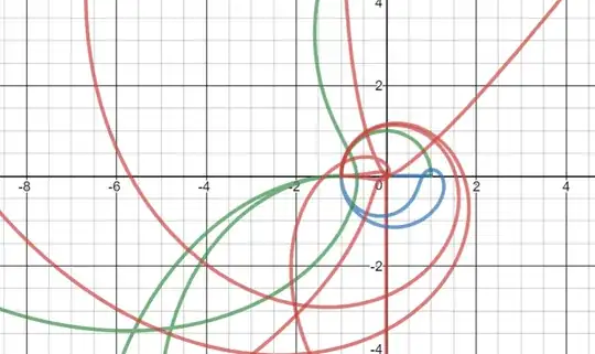

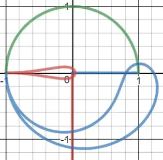

Once again we see apparently perpendicular connections, though trivially all at $(-1,0)$.
There are new patterns though. We get almost cardioids, but not quite. We saw two interesting loop looking shapes as well. Any idea what these are? It appears these loops get really long and form the quasi-cardioids.
Is it the case that these loops always connect back to $(-1,0)$ from the same direction from which they came?
And is there a 4-turned patter? The first line connecting to $(-1,0)$ came from above, the second line connecting to $(-1,0)$ came from the right, the third came from below, the fourth from the left, and if we keep graphing more of these, the fifth comes from above once again.
Can we do an analysis to these different shapes? My graphing calculator isn't the best, and I have to do these one by one... Particularly, what can we say about $z\uparrow\uparrow x$ for $|z|=1$ and $x\in\mathbb R$?

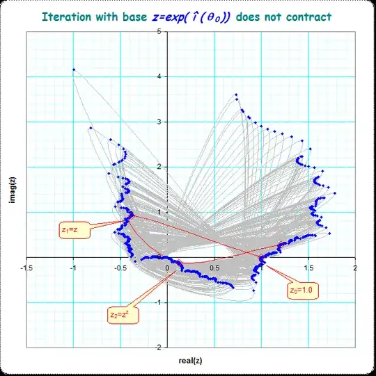

  • at the last remark: I found one likely value $\theta_0= 1.2486079913755423879 \cdot \pi/2$ where the iteration towards fixpoints changes from convergence (=1-step-periodic) fixpoint towards divergence (multi-step-periodic) points . This is due the fact that the value for $u$ with $\exp(u \cdot \exp(-u))=z$ increases over $u>1$ and for $u \lt 1$ it is known that the iteration converges by D.Shell & W.Thron. (this is just one critial $\theta_0$, maybe there are more because $z=f(u)$ is not linear; didn't check this so far) – Gottfried Helms May 12 '19 at 19:21
  • I did my computations with Pari/GP and default precision of 200 (dec) digits. A quick plot plot(th=0,2, abs(u= - LambertW(-(c=I*th*Pi)) )) shows a somehow logarithm-curve and thus that there is only *one* $\theta_0$ where with $u=f(\theta_0)$ we can have $|u|=1$ So we should have only one $\theta_0$ where this change from convergence to divergence/periodic fixpoints occurs. In the plot-command the $c$-variablename is meant as $\log(z)$ and $u$ as used in the previous comment. – Gottfried Helms May 12 '19 at 19:34

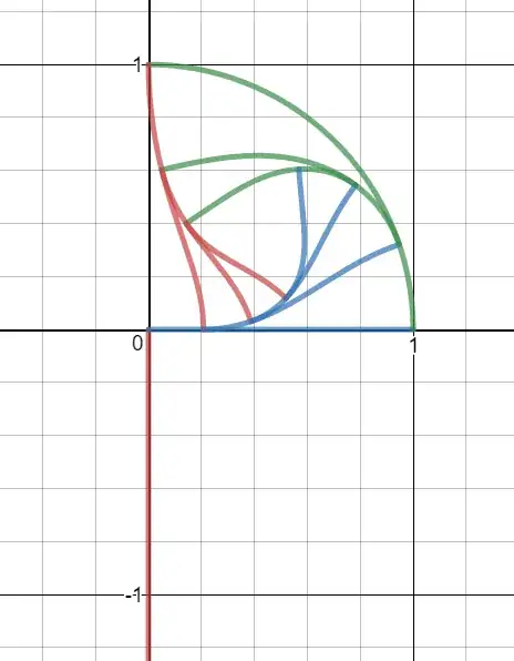

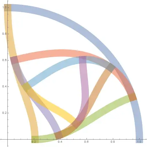

All of the relevant patterns here seem to involve only nonnegative inputs, so define $f:[0,\infty)\to \mathbb C$ by $f\left(t\right)=\begin{cases}i^{t} & \text{ if }t\in[0,1)\\i^{f\left(t-1\right)} & \text{ if }t>1\end{cases}$. To get a sense for the graph of $f$, we can use different colors for $[0,1)$, $[1,2)$,...
Graph

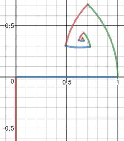

Here is a graph of $f(t)$ for $t\in[0,9)$: spiral image
It starts at $1$, then follows an indigo quarter-circle to $i$, then an orange sort of vertical sigmoid to $e^-\pi/2$, and then a green sigmoid up towards what appears to be a point on the initial quarter-circle, and spiraling inwards with colors like red, purple, brown, blue, yellow, and then pink.
For notational convenience, set $p=\dfrac{\pi}{2}$ and $g\left(t\right)=i^{t}=\left(e^{ip}\right)^{t}=e^{ipt}=\exp\left(ipt\right)$. This makes $f\left(t\right)=\begin{cases}g\left(t\right) & \text{ if }t\in[0,1)\\g\left(f\left(t-1\right)\right) & \text{ if }t>1\end{cases}$.
Do these actually connect? Yes
Note that $f$ is continuous (i.e. the graph is connected) since $1=g\left(0\right)$. For example, $f\left(2\right)=g\left(g\left(g\left(2-2\right)\right)\right)=g\left(g\left(2-1\right)\right)={\displaystyle \lim_{t\to2^{-}}}f\left(t\right)$. Therefore, there no breaks in the graph at $i$, $e^{-p}$, etc.
There is another sequence of apparent connections "in the middle", with the first being where the third arc (green) meets the original quarter-circle (indigo) at $\exp\left(ipe^{-p}\right)$. For this particular one, note that $f\left(e^{-p}\right)=g\left(e^{-p}\right)=g\left(g\left(i\right)\right)=g\left(g\left(f\left(1\right)\right)\right)=f\left(3\right)$. The others are simply the result of applying $g$ to both sides: For example, since $f\left(3-\varepsilon\right)\approx f\left(e^{-p}\right)$ and there's an intersection around $f\left(4-\varepsilon\right)=g\left(f\left(3-\varepsilon\right)\right)\approx g\left(f\left(e^{-p}\right)\right)=f\left(1+e^{-p}\right)$ as well, etc.
"the branches connect perpendicularly" True.
Now we will show that the intersections in the diagram that look perpendicular all really are. To start, let's look at two particular ones.
Intersection at $i$
On $\left[0,1\right]$, we have $f\left(t\right)=g\left(t\right)$, which draws a quarter-circle in the complex plane, and it's horizontal at $i$ ($t=1$). On $\left[1,2\right]$, we have $f\left(t\right)=g\left(g\left(t-1\right)\right)$. Taking the derivative of this and evaluating at $t=1$ (to take the limit of the derivative of $f$ as $t$ approaches $1$ from above), we get $\boxed{-ip^{2}}$, so $f$ is moving vertically for $t$ just above $1$. As vertical is perpendicular to horizontal, we do have a right angle at $i$.
Intersection at $\exp\left(ipe^{-p}\right)$
Note that $f\left(e^{-p}\right)=g\left(e^{-p}\right)=g\left(g\left(i\right)\right)=g\left(g\left(f\left(1\right)\right)\right)=f\left(3\right)$. The derivative of $g\left(g\left(g\left(t-2\right)\right)\right)$ as $t$ approaches $3$ is $p^{3}e^{-p}\sin\left(p\left(1+e^{-p}\right)\right)-i\left(p^{3}e^{-p}\cos\left(p\left(1+e^{-p}\right)\right)\right)$. Since $\cos\left(p+x\right)=-\sin x$ and $\sin\left(p+x\right)=\cos x$, this simplifies to $\boxed{p^{3}e^{-p}\left(\cos\left(pe^{-p}\right)+i\sin\left(pe^{-p}\right)\right)}$.
And the derivative of $f\left(t\right)=g\left(t\right)$ at $t=e^{-p}$ is $-p\sin\left(pe^{-p}\right)+i\left(p\cos\left(pe^{-p}\right)\right)=\boxed{p\left(-\sin\left(pe^{-p}\right)+i\cos\left(pe^{-p}\right)\right)}$.
These two complex numbers are perpendicular as vectors, so this is a right angle as well.
The other intersections
To get all of the other intersections, note that $g\left(t\right)$ has a complex derivative of $ipe^{ipt}\ne0$, so it is conformal (see, for example, this MSE question), meaning that $g$ preserves the local angles in the diagram. Because of the recursive definition of $f$, this means that the two intersections considered above propagate along the diagram. For example, since there's a perpendicular intersection around $f\left(3-\varepsilon\right)\approx f\left(e^{-p}\right)$, there's a perpendicular intersection around $f\left(4-\varepsilon\right)\approx f\left(1+e^{-p}\right)$.
"Are these shapes similar to one another?" No.
I'm not certain how to interpret this question, but everything that comes to mind has the answer "no". For example, the first part of the graph of f is a quarter circle, but the fourth part (red) is certainly not.

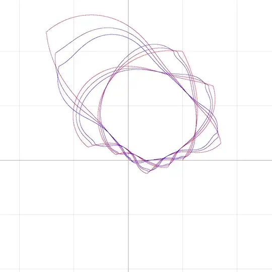

This is not an answer to the question, but a programm to play around with.
As I stated in a comment above, I made a programm where you can test out different values for the complex tetration.
The important part of the programm is:

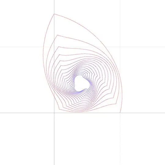

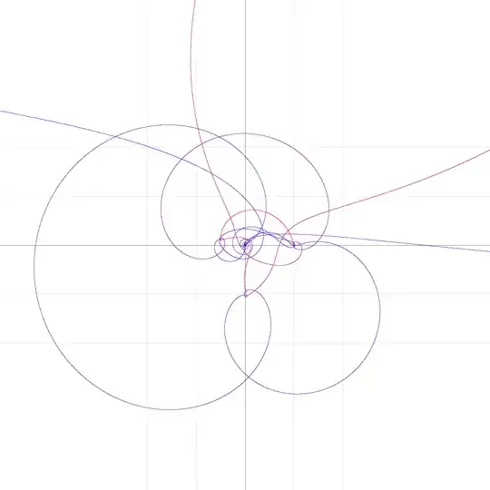

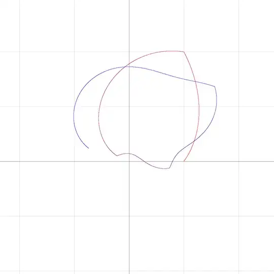

Here are some interesting plots for your function: (red is the start, blue is the end)
$$z = 1 + 2i$$ $$t \in [0, 5]$$
plot
$$z = 1 + 2i$$ $$t \in [0, 30]$$
plot
This seems to orbit around, but doesn't approach a fixpoint, as far as my experiments went.
$$z = 1.5 i$$ $$t \in [0, 50]$$
plot
This seems to approach a fixpoint.
$$z = -0.5 + 0.1 i$$ $$t \in [0, 10]$$
plot
This looks chaotic and chrashed my programm via the huge numbers it spat out.

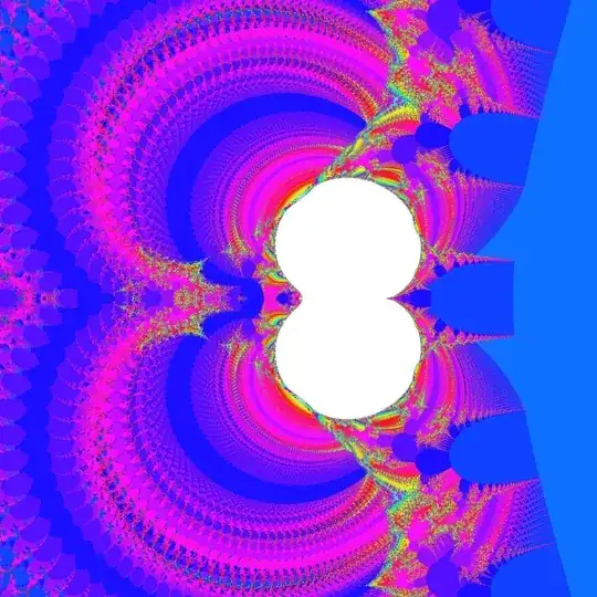

An experiment about the stability of $z ↑ ↑ t$
I got curious and wanted to know when your function is stable and when it violently goes everywhere.
But I didn't knew how to test this behaviour correctly.
So I just called the plot messy, if $|z ↑ ↑ t|$ exceeds some limiting value called $\text{Max}$.
Now I tested a giant array of points for $z$ and colored a pixel white if the plot was not messy, and made it colorful, depending on how long it took to become messy.
The calculation took 55 minutes, but the result is a pretty cool fractal!
Of course, this gives only an idea of how the actual picture should look - This is just an approximation and I went with a very simple condition to determine if a plot is chaotic. This might exclude some points that are actually stable and might include some points that are actually messy.
The view-window is $-5$ to $5$ on both axis.
$$t \in [0, 100]$$
$$\Delta t = 0.01$$
$$\text{Max} = 100$$
When is the funtion not messy?
I think this is quite a beautiful picture. The fractal structure makes sense, because the tetration was defined recursivly - in a way, this is iteration. Some of the structures look similar to the fractal generated by Newtons' method for $e^x + 1$.

    I made a diagram that showes if the plot for $z$ is messy. However, this is an approximation. How can we define a better condition? When is the plot chaotic? – halcyclon May 22 '17 at 18:10
  • I like the fractal, but suspect a much lower "Max" will suffice. Maybe 2 (as in the Mandelbrot set) or something a vit higher like 4 (just to be safe). @Simply as they will be interested too. – Mark S. May 22 '17 at 18:15
  • @MarkS. Very interested indeed – Simply Beautiful Art May 22 '17 at 21:41
    The white area looks like the "Shell-Thron-region" (see wikipedia/tetration) which mark *the bases* b which have a convergent trajectory when iterating infinitely. – Gottfried Helms May 22 '17 at 22:40
    In your third picture, surely you mean $z=1.5 i $ (the imaginary base, not the real one)? – Gottfried Helms May 22 '17 at 22:45

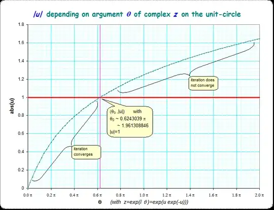

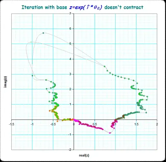

You ask:
When $|z|=1,\operatorname{arg}(z)=\theta\in(-,\pi]$, then $\lim\limits_{x\to\infty}z\uparrow\uparrow x$ tends to exist for $\theta<\theta_0$ and diverges for $\theta>\theta_0$. What is this $\theta_0$? And is my conclusion correct?
For the question of fixpoints of the iteration of $x \to z^x$ the observation is relevant that we can introduce the variables $t$ and $u=\log(t)$ writing $z=t^{1/t}$ and $z=\exp(u \cdot \exp(-u))$
For this we have a proof of D. Shell & W. Thron that
  • for $|u|<1$ the iteration converges to the fixpoint $t$,
  • for $|u|>1$ the iteration diverges, and
  • for $|u|=1$ it converges or diverges depending on the algebraic character of $\arg(u)/\pi$

Now, if on the other hand we have by your demand $|z|=1$ and thus $z=\exp(î \theta)$, then we have $\log(z) = u \exp(-u) = î \theta$.
There is a nice formula using the LambertW-function to find $u$ from $\log(z)$ such that we have $$ u = - \text{LambertW}(- \log(z)) \\ = - \text{LambertW}(- î \theta) $$ If we define a function $$f(\theta) =|u| = | - \text{LambertW}(- î \theta) | \qquad \qquad \text {for } 0 \le \theta \le 2 \pi $$ then we find a monoton increasing curve: image
It shows that there is only one point where $f(\theta_0)=|u|=1$ and smaller $\theta$ lead to smaller $|u|$ and thus convergence in the iteration, and larger $\theta$ lead to larger $|u|$ and thus to divergence (set-of-periodic-points) in the iteration according to the mentioned categorization of Shell/Thron.
About $\theta_0$ such that $|z|=1$ and $|u|=1$ (third case of above list)
I found the approximation for $\theta_0$ using the solver in Pari/GP
$\qquad \qquad $ th0 = solve(th=1.9,2.0, abs(-LambertW(-I*th))-1)
getting $$\theta_0 = 1.961308846... = 0.6243039957... \cdot \pi $$
Using this $\theta_0$ I show the scatterplot of some first iterates of $z_0=1$:
The blue dots are the first 1000 iterates and by the grey connection-lines we see some very chaotic behave. To have a better grip I've also marked the first four iterates with red color.
But we can do better; the "border" of the figure seems (well:seems) to be interpolatable. And in fact we get smoother multi-section trajectories if we document only each 3rd or 11 or so dot and add an interpolating line. The following image shows the iterates in a 68-fold multi-sectioned trajectory .
In the picture I have colored the first 5 sections of the full trajectory up to some 200 steps for each section and with their dots connected. They give nicer lines, seemingly closing the figure, and are partially (nearly) overlaid.
This can be done even more dense - in fact even arbitrarily dense!
This can be done if we use values from the convergents of the continued fraction of $\arg(u)/\pi$. Then at multi-sections accordingly with $s=68$, $s=797$, $s=5715$ ,$s=2 \cdot 15517$, $s=...$ stepwidths we get increasingly dense sectional trajectories (while of course they are always sets of discrete/disconnected complex points).
That trajectories seem to not-to-contract, so we don't get convergence.
This is of course conjectured by visual inspection, but can be backed by the heuristic, that increasing values from the convergents of the continued fraction provides smaller distances between the steps in a sectioned trajectory. And this must then mean that we arrive arbitrarily near at $z_{-1}=0$ and then arbitrarily "near" at $z_{-2} = \log_z(0)$; so we shall always have extremely far-away dots in the picture.
The latter consideration is only based on observation and conclusion - it would be good if one could make a proof for this....
