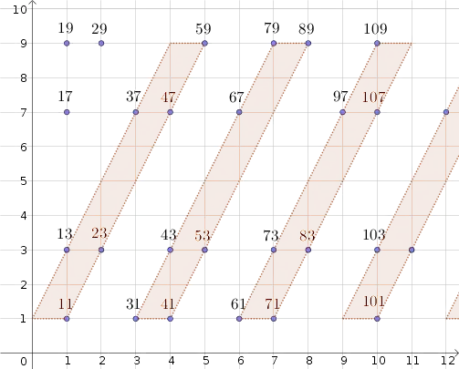

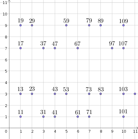

As already introduced in this post, given the series of prime numbers greater than $9$, let organize them in four rows, according to their last digit ($1,3,7$ or $9$). The column in which they are displayed is the ten to which they belong, as illustrated in the following scheme.
Within this scheme, and given the tens $N=0,3,6,9\ldots$, we can uniquely define a parallelogram by means of the four points corresponding to the four integers $N+1$, $(N+10)+1$, $(N+40)+9$ and $(N+50)+9$, as easily illustrated below.
For instance, the parallelogram corresponding to the ten $N=3$ is defined by the integers $31,41,79$ and $89$, whereas the one corresponding to $N=6$ is defined by $61,71,109, 119$.

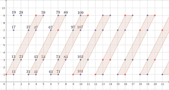

In the following picture, I denote with a red cross some of the missing primes, i.e. those integers that occupy one of the $8$ possible positions that the primes can occupy on the parallelograms, but that are not primes.

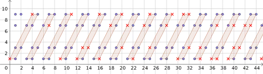

And here some more (sorry for the bad quality).
