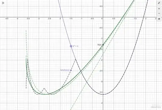

Similar to tippy2tina's answer, one can easily numerically generate such functions on $\mathbb R$ when they converge monotonically to a fixed-point if a fixed-point exists. Let $f^k(x)=\operatorname{nest}(f,x,k)$. In this case consider for $c\le-1/4$:
$$p(x)=x^2+c,\\q(x)=p^{-1}(x)=\sqrt{x-c}$$
where the inverse, $q$, has $q^n(x)\to\beta=\frac{1+\sqrt{1-4c}}2$ monotonically and
$$q'(\beta)=\frac1{2\beta}$$
describing its rate of convergence
$$q^{n+1}(x)-\beta\sim\frac{q^n(x)-\beta}{2\beta}$$
which implies we can have
$$q^{n+\alpha}(x)-\beta\sim\frac{q^n(x)-\beta}{(2\beta)^\alpha}$$
and thus we may define
$$q^\alpha(x)=\lim_{n\to\infty}p^n\left(\beta+\frac{q^n(x)-\beta}{(2\beta)^\alpha}\right)$$
In your case, you desire to find
$$p^{1/k}(x)=q^{-1/k}(x)=\lim_{n\to\infty}p^n\left(\beta+\frac{q^n(x)-\beta}{(2\beta)^{-1/k}}\right)$$
which will converge to a real solution over $[a,\infty)$ for some $a\le0$. Note that $p$ has two inverses, so only a part of the solution is accounted for, while the other part cannot be real due to issues described in the linked posts.
Graphically for solving in the case of $c=-3.6$ and $k=3:$
