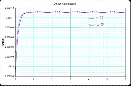

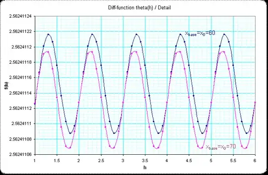

  • Have you tried to compare the half-iterates of $x^2$ when you solve by the two versions of regular iteration according to the two fixpoints (0 and 1) of that same function? I suspect, we'll have "wobbling" even between that methods of halfiteration of the same function... – Gottfried Helms Oct 08 '12 at 13:58
  • x^2 shows double exponential growth from the repelling fixed point of 1. I don't know how to get double exponential growth from the attracting fixed point of zero. btw, I had a typo in my original calculation. I also actually calculated the half iterate of x^2+x, for x=800000000, instead of the half iterate of x^2+0.25. To shift between the two equivalent functions, you half to add or subtract 1/2. – Sheldon L Oct 08 '12 at 14:08

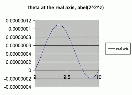

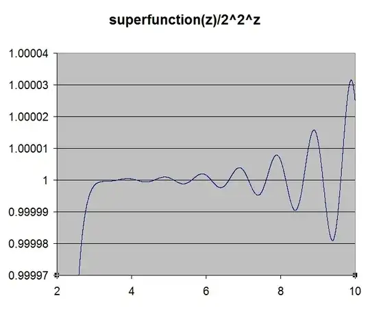

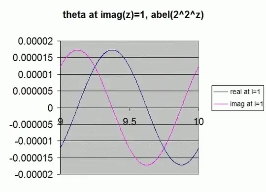

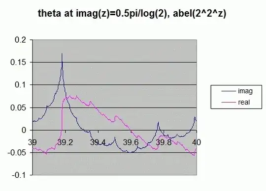

  • @mick, Perhaps a picture would help. $\alpha^{-1}(z+k)/2^{2^z}$ k is chosen to get approximately 50% duty cycle. superfunction(z+k)/2^2^z – Sheldon L Oct 12 '12 at 22:27

Remark: Shel, possibly I misunderstood something in your post and this pictures here may be completely crap. I expected diff/theta-function-curve crossing the x-axis, but see only the wobbling around a certain y-value. So if this is all wrong, please let me know and I'll improve or delete this post
An image for the theta-function in your (Sheldon's) original post. I understand the z-parameter in the theta-function as "height"-parameter, when some number $x_0$ is iterated $h$ - (or $z$ -) times to the number $x_h$ .
here is how I implemented the diff-function:
{shtheta(h,x0=1)= local(a,xh,h1,l2=log(2));
  xh = iterateByAbelfunction(x0,h);
  h1 = log(log(xh)/l2)/l2;  \\ h1 should give the height-difference in terms of
         \\ the other function $x^2$
  return(h1-h);}
Your example of wobbling was at $x_0=800000000$ - here I begin at $x_0=60$ and show the iterates in steps of 1/10 up to $x_6$ which crosses your 800000000 at height of about $2.3239$ . This is the blue curve in the first plot. The magenta curve is the equivalent, but begins at $x_0=70$ and it should be a left-shift of the blue curve by some small $h$ (just to improve the visualization of the problem):
The next picture is the detail of bigger "heights" (from $x_1 \approx 3600 $ on) and the magenta-curve shifted to match at the last point at $h=6$ to make the fine sinusoidal form visible.
[Added]: Hmm, I think now I understand the question and what's going on better now after some more consideration. And I leave the pictures so far, because they are still informative even if not directly to the point.
My hypothese for now: the "wobbling" which leads to the change of sign in your theta-function is caused by differences or better by a different behave of the functions when derivatives with respect to the height-parameter are considered. Without exact inspection I assume, that the derivatives of all orders of the $x^2$-function with respect to the iteration-height-parameter are always positive but that of the Abel-iteration may be mixed so that the change of the function-value is not "completely smooth".
I hope I could made this comprehensible so far, perhaps I can do better later ...
[added2]: I took a closer look at your theta-function and searched for change-signs earlier than your $x_0 = 8e8 $. I found some, for instance $x_0 = 2000 $ and the first 20 iterates in steps of 1/10. Then I scanned 16 areas beginning at $x_0 = 10^{k/2} $ and iterating from $ x_0 $ 20 times by height of 1/10. Each of the latter trajectories make a line in the following plot, also the lines are normalized such that their amplitude is between $ \pm 1 $. Only that lines are drawn which contain at least one sign-change.
sign-changes
  • Hey Gottfried; your pictures match the results I've generated. The theta function converges to a 1-cyclic function, and not to a constant. That is why the half iterates of one function are sometimes bigger and sometimes smaller than the half iterates of the other functions, as the two superfunctions $\alpha_{x^2}^{-1}$, and $\alpha_{x^2+0.25}^{-1}$ criss cross each other an infinite number of times, if lined up at larger real values. Thanks for all the work again. – Sheldon L Oct 11 '12 at 13:36
  • @Shel: have you data/analytics of the derivatives with respect to the height parameter? I've tried to do this numerically but don't arrive at high derivatives due to the binary-search-implementation of the inverse Abel-function. I got negative derivatives when order gt 7 but am very unsure about the reliability of that toy-computations. – Gottfried Helms Oct 11 '12 at 14:00
  • yes, I can generate accurate numerical values for the 1-cyclic function that $\theta(z)$ converges to, as well as for any of its derivatives, although I switched to generating $\theta_2(z)= \alpha_{x^2+0.25}(\alpha^{-1}{x^2}) = \alpha{x^2+0.25}(2^{2^z})$
    I can generate $\theta_2(z)$ in the complex plane as well, as long as $\Im(z)<\pi/(2\log(2))$, which I believe is its analytic boundary.
    – Sheldon L Oct 11 '12 at 14:16
** ADDITIONAL UPDATES, answer **
Again, thanks, Gottfried, and Will, for your updates and answers, and for the important theoretical background proving the existence of the parabolic solution. For this section of updates, I use $\alpha(z)$ as the abel function of $x^2+0.25$, so that
$\alpha(z)=\alpha(z^2+0.25)-1$
$\theta(z)=\lim_{(n \to \infty)} {\alpha(s(z+n))-z-n}$
$s(z)=2^{2^z}$, where 2^2^z is the superfunction for $x^2$, $s(z)=s^2(z-1)$
The reason for the switch, is that 2^2^z is well defined in the complex plane, making it easier to identify the analytic boundary of $\theta(z)$ in the complex plane. Earlier, I was generating a slightly different $\theta(z)$ from the composition of the abel function of $z^2$ with the superfunction of $z^2+0.25$. The key is that 2^2^z is periodic in the complex plane with period=$2\pi i/\log(2)$. In addition, as z increases, the absolute value of 2^2^z grows without bounds in the neighborhood of the real axis if $|\Im(z)|<0.5\pi/\log(2)$. The $\theta(z)$ function only converges to a 1-cyclic function if 2^2^z is growing in magnitude. To understand this, consider the function $f(z)=\sqrt{z^2-0.25}-z$. If the magnitude of z is large enough, than f(z) is an arbitrarily small function.
To help understand the definition of $\theta(z)$, consider one other function as an "alternative" abel/superfunction function of x^2+0.25. Define $g(z)=\sqrt{x-0.25}$, $g^{-1}(z)=z^2+0.25$, and consider the following "alternative" abel function for x^2+0.25.
$\alpha_{alt}(z)=\lim_{(n \to \infty)} \log_2(\log_2(g^{-1 o n}(z)))-n$
$\alpha_{alt}^{-1}(z)=\lim_{(n \to \infty)} {g^{o n}(2^{2^{z+n}})}$

Also, $\theta(z)=\alpha(\alpha_{alt}^{-1}(z))$, which is easy to show. Hopefully, this is not too confusing, as my time this morning is limited, and I want to post some plots of $\theta(z)$, at the real axis, and in the complex plane.
$\theta$ at the real axis. Here, I arbitrarily set $\theta(n)=0$, for large enough integers. Note that 2^2^9, is a really big number, 10^154, so theta(z) has converged. theta real axis
$\theta$ at $\Im(z)=1$, note the magnitude of $\theta(z)$ is much larger here.
theta imag i=1
And, here is the analytic limit of theta, $\Im(z)=0.5\pi/\log(2)$, showing the fractal behavior since 2^2^z is no longer increasing, but instead, |2^2^z|=1. theta imag i=1
Finally, here is a plot of the ratio of the ratio of the two superfunctions; the inverse abel function for $z^2+0.25$, and 2^2^z, lined up to approximately 50% duty cycle as z increases.
superfunction(z)/2^2^z
