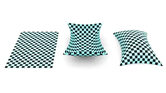

I was writing some exercises about the AM-GM inequality and I got carried away by the following (pretty nontrivial, I believe) question:
Q: By properly folding a common $210mm\times 297mm$ sheet of paper, what is the maximum amount of water such a sheet is able to contain?

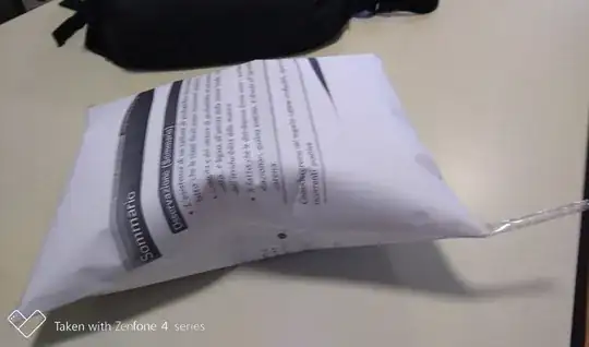

The volume of the optimal box (on the right) is about $1.128l$. But the volume of the butterfly (in my left hand) seems to be much bigger and I am not sure at all about the shape of the optimal folded sheet. Is is something boat-like?
Clarifications: we may assume to have a magical glue to prevent water from leaking through the cracks, or for glueing together points of the surface. Solutions where parts of the sheet are cut out, then glued back together deserve to be considered as separate cases. On the other hand these cases are trivial, as pointed by joriki in the comments below. The isoperimetric inequality gives that the maximum volume is $<2.072l$.

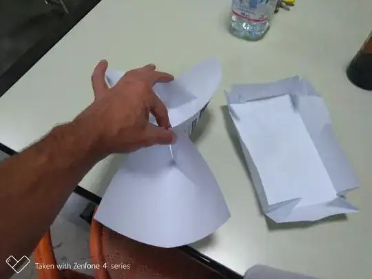

As pointed out by Rahul, here it is a way for realizing the optimal configuration: the maximum capacity of the following A4+A4 bag exceeds $2.8l$.

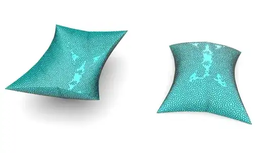

I got curious so I implemented a quick-and-dirty tension field simulation that optimizes for $\gamma$ and $M_{\gamma}$. Source code is here (needs the header-only Eigen and Libigl libraries): https://github.com/evouga/DaurizioPaper
Here is a rendering of the numerical solution, from above and below (the volume is roughly 1.56 liters).
EDIT 2: A sketch of the orientation of $\tau$ on the surface:

    Could you comment on how your code attempts to optimize for $\gamma$? The only thing mentioned in your fantastic answer is that $M_\gamma$ must meet $\gamma$ at a right angle. But how did you compute various $\gamma$? – Greg Hurst Jul 21 '18 at 02:29
    I did a small comparison of your optimization code with the paper-bag approximate formula in Wiki. The results are qualitatively the same with the main difference being that you have a roughly 7% higher value (tested this for $w/h \in [0.4,2.0]$ and checked convergence wrt the mesh size). Assuming your code has no bugs a likely reason for the discrepancy is that the approximate formula is simply not that accurate, perhaps it was computed with a too low mesh resolution which would lead to a smaller volume. – Winther Jul 21 '18 at 02:45
    @user7530 Would it be possible to mark the regions of compression and/or tension streamlines on the renders? It's hard to see from the plot if any exist, and you make a point of it in your answer. Great work anyway! – Mario Carneiro Jul 21 '18 at 10:17
    What happens if you run your simulation for a disk, instead of a rectangle? – Jack D'Aurizio Jul 23 '18 at 12:48
  • @MarioCarneiro tension streamlines would require some nontrivial coding, but I've added a figure sketching the direction of tension. Don't trust the hourglass region at the top---the surface is very close to being in pure tension there and there is a lot of numerical noise. – user7530 Jul 26 '18 at 19:18

    This is interesting since it provides a mechanical way for realizing the optimal configuration: it is enough to glue together two A4 sheets along their boundaries, then inflate air inside. – Jack D'Aurizio Jul 19 '18 at 17:42
    That assumes that there is no solution where one (or more) edges of the sheet are curved (i.e., thin curved slices cut out), that yields a greater volume. I don't know if that assumption is correct. Do you know of any way to prove, or a reason to assume, that a slightly smaller non-rectangular sheet cannot have even larger volume? (Stuffing a pillow case, or blowing up a mylar balloon constructed of two sheets glued together, seems to indicate that a smaller sheet cannot have larger volume.. but I just don't know. I'm only asking, not claiming anything.) – Nominal Animal Jul 19 '18 at 22:50
    @NominalAnimal: If you have a solution with part of the square removed, you can achieve the same with the full square by crushing/wrinkling the extra material to "hide" it, as argued in the first section of user7530's answer. –  Jul 20 '18 at 05:30
  • @Rahul: Ah, right; the corrugations/folds having zero volume, i.e. flat along the surface, with tight creases. I think I was hung up on the curved edge idea, and didn't realize the creases can be short, shaped like e.g. lenses in the middle, or quadrilaterals/diamonds near the corners, to provide exactly that. Thanks! – Nominal Animal Jul 20 '18 at 14:20

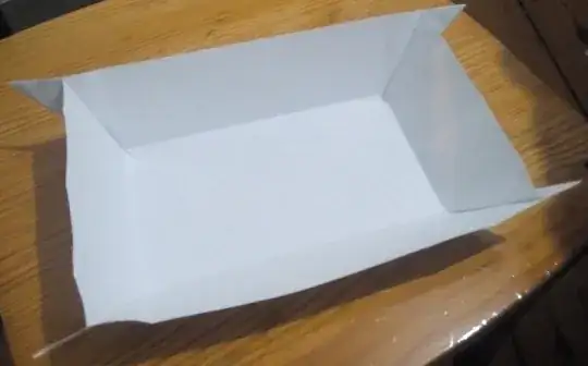

This is certainly not optimal, but comparatively straightforward to calculate and a moderate improvement over the previous solutions.
If we let the sides of the box fall outward, the top rectangular area of the resulting prism increases to first order whereas the height only decreases to second order, so there's a non-zero optimal angle of inclination for the sides.
Let $x=210\text{mm}$ be the width and $y=297\text{mm}$ the length of the paper, and introduce three variables: the height $h$, the angle of inclination $\phi$ of the long sides and the angle of inclination $\xi$ of the short sides. Then at height $\alpha h$, with $0\le\alpha\le1$, a rectangular cross-section of the prism of height $h\mathrm d\alpha$ has volume
$$ \left(x-2\frac h{\cos\phi}+\alpha\cdot2h\tan\phi\right)\left(y-2\frac h{\cos\xi}+\alpha\cdot2h\tan\xi\right)h\mathrm d\alpha\;, $$
and integrating over $\alpha$ yields the volume
$$ \left(\left(x-2\frac h{\cos\phi}+h\tan\phi\right)\left(y-2\frac h{\cos\xi}+h\tan\xi\right)+\frac13h^2\tan\phi\tan\xi\right)h\;. $$
I don't see how to get a closed form for the optimal parameters, but I optimized them numerically, with the result
$$ h\approx47.62\text{mm}\;,\\ \phi\approx0.55112\;,\\ \xi\approx0.56838 $$
and resulting volume
$$ V\approx1.315679370667\,l\;. $$

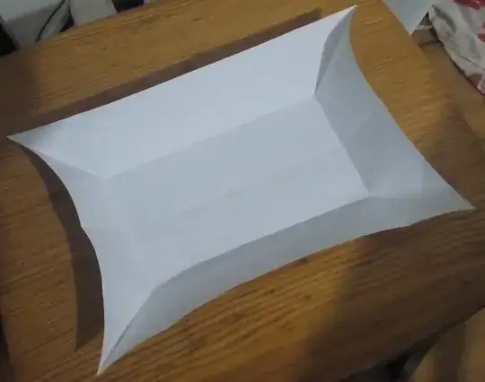

Here's a rough attempt at building this:
paper holds water glued
P.S.:
This is the first picture I took, before I realized that I could glue the corners to force the paper to stay in the prism shape. After seeing the images that came out of user7530's cool simulation, I'm now thinking that the paper was trying to take on the optimal form and I was just interfering with it :-)
paper holds water all by itself

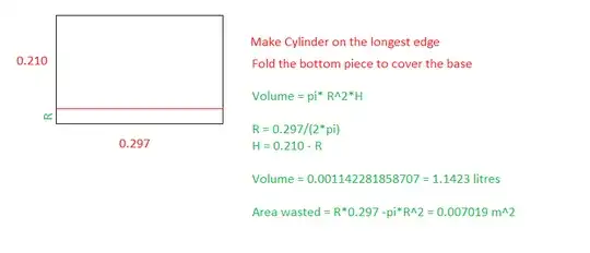

This may not be the optimum. But an easy solution with larger volume than the box. 1.14228 l. (Of course we need to tape it at base to hold)
Solution explained
