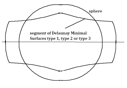

I am assuming that the given cloth can be arbitrarily cut and re-glued to enclose volume.
Using Variational calculus it can be established that:
Given area A and volume V, all minimal area surfaces of constant mean curvature H (instead of a single radius R) are satisfied by DeLaunay Unduloids and their combinations
$$ H =\frac{2A}{3V}=\frac{1}{r} = 1~ $$
being equivalent to a sphere, that cannot be exceeded.
A roughly sketched example of meridians of maximum 3D volume for given surface area.
EDIT1:
Alternately the warp and weft fibers should be rotated in order to make an iso-lineal mapping where fiber length is conserved for maximum enclosed volume.
Narasimham
