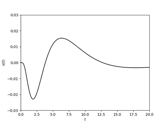

It is interesting to see the behavior of the derivatives of this function. We know that $\dot{x} = x(at)$. Differentiating it, we have $$ \ddot{x} = \frac{d}{dt} x(at) = \frac{d(at)}{dt} \frac{d}{d(at)} x(at) = a \dot{x}(at) = a x(a^2 t), $$ $$ \dddot{x} = \frac{d}{dt} a x(a^2 t) = a \frac{d(a^2t)}{dt} \frac{d}{d(a^2t)} x(a^2t) = a^3 \dot{x}(a^2t) = a^3 x(a^3 t), $$ or, in general, $$ x^{(n)} = a^{n(n-1)/2} x(a^n t), $$ which can be readly proved by induction. Therefore, it is easy to see that $x^{(n)}(0) = 0$ for all $n$, i.e., showing that the solution is non-analytical at $t=0$. Here is the graph of the solution for $a=2$ and $A=1$. enter image description here

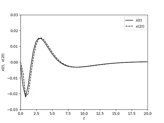

And here is a graph comparing $\dot{x}(t)$ to $x(2t)$. This graph is rougher on purpose to allow an easy distinction between both curves. For a thinner resolution, the matching is perfect.

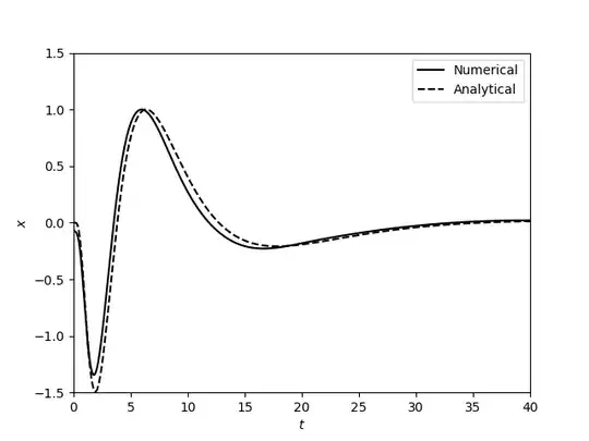

As the last line of $A^1_{ij}$ is undefined, it can be used to providing the "boundary" condition. It is important to notice that all solutions are equal up to a multiplicative constant. Therefore, the solution can be obtained by $$ x_i = (A_{ij})^{-1} B_j, $$ in which $B_j = 0$ for all $j$, except for the position in which the condition was imposed. Here is a numerical solution obtained for $a=2$, $h = 4\times 10^{-2}$ and $T=160$: enter image description here
Both solutions were 'normalized' to allow a better comparison. There is a good agreement among the solutions. It is interesting to see that the numerical solution does not satisfy $x(0) = 0$, only approximately. It is also important that the domain be sufficiently large in order that the most relevant oscillations are contained in the region $0<t<T/a^2$. The size of the domain is more important to the accuracy of the solution than the step size.

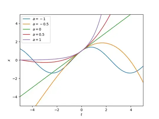

For $1\leq a\leq 1$ the power series solution, $$ x = A\sum_{n=0}^\infty \frac{a^{n(n-1)/2}}{n!} t^n, $$ converges. For $a=0$ the solution degenerates to $x=kt$, for $a=1$, to $x = k \exp t$ and for $a=-1$ to $x=k\sin (t+\pi/4)$ (I found this one quite surprising!). Solutions for intermediates values of $a$ are shown in the graph:enter image description here
