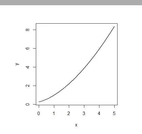

By the way, I did some numerical approximation taking $f(1)=1$ as 'initial' condition, and I ended up with this $f$:
Here are some values.
$$\begin{array}\\x & y\\ 0.0 &0.2887337\\ 0.5 &0.5656723\\ 1.0 &1.0000000\\ 1.5 &1.5602165\\ 2.0 &2.2340116\\ 2.5 &3.0138627\\ 3.0 &3.8944997\\ 3.5 &4.8719327\\ 4.0 &5.9429892\\ 4.5 &7.1050584\\ 5.0 &8.3559366\\ \end{array}$$
The problem seems to be well conditioned and the behavior of the iterative procedure looked stable. Moreover, other functions $f$, for different initial values at $x=1$ seem to be multiples of the one given above (say $f_1$), in fact, of the form $$f(x)=f(1)\cdot f_1(x).$$ Also $f_1$ is likely positive, so the last equation and this condition would imply $$\forall x\ge 0,\;\textrm{sgn} f(x) = \textrm{sgn} f(1).$$
On the other hand, I still don't see a reasonable closed form expression for such a function.
