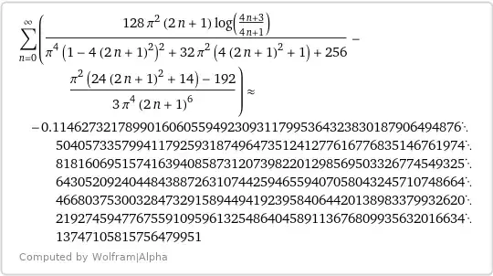

I1-S Sum S

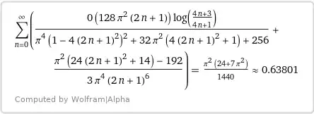

and $$I_1=\sum\limits_{n=0}^\infty \Im\left(-\dfrac4{4\pi n+3\pi+4i}+\dfrac4{4\pi n+\pi+4i}\right) \ln\dfrac{4n + 3}{4n+1}.\tag{7b}$$
The poly-Stieltjes constants using.
The poly-Stieltjjes constants do not belong to the standard special functions, but they are defined in the Oliver Oloa answer as the known specific functions.

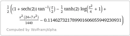

In particular, from $(7b)$ and the given definition in the form of $$\gamma_1(a,b) = \lim\limits_{N\to\infty}\left(\sum\limits_{n=1}^N \dfrac{\ln(n+a)}{n+b} - \dfrac{\ln N^2}2\right)\tag{$\large\diamond$}$$ should $$\begin{align} &I_1= \dfrac{16}{16+9\pi^2}\,\ln3 - \dfrac1\pi \Im\left(\gamma_1\left(\small\dfrac34,\frac34+\frac i\pi\right) - \gamma_1\left(\small\dfrac14,\frac34+\frac i\pi\right) \right)\\[4pt] &-\dfrac{16}{16+\pi^2}\,\ln3 + \dfrac1\pi \Im\left(\gamma_1\left(\small\dfrac34,\frac14+\frac i\pi\right) - \gamma_1\left(\small\dfrac14,\frac14+\frac i\pi\right) \right), \end{align}\tag8$$
$$\begin{align} &I=-\dfrac14\tanh 2\ln\left(\dfrac{\pi^2}4+1\right) + \dfrac{1+\operatorname{sech}2}2 \arctan \,\dfrac\pi2 +\dfrac{64\pi^2}{(16+\pi^2)(16+9\pi^2)}\\[4pt] &+\dfrac1{2\pi}\Im\left(\gamma_1\left(\small\dfrac34,\frac34+\frac i\pi\right) - \gamma_1\left(\small\dfrac14,\frac34+\frac i\pi\right) \right)\\[4pt] &- \dfrac1{2\pi} \Im\left(\gamma_1\left(\small\dfrac34,\frac14+\frac i\pi\right) - \gamma_1\left(\small\dfrac14,\frac14+\frac i\pi\right) \right). \end{align}\tag9$$
Formula $(9)$ gives the closed-form representation, which cannot be used in the popular package Wolfram Alpha.
Results.
  • Obtained the alternatiive notation of the poly-Stieltjes closed form $(9)$ for the given integral.
  • Obtained the calculating formulas $(6),(7a)$ via the elementary functions series. Evaluated value
