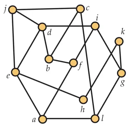

I've been trying to find out if this graph is planar or not for a while and have really been coming up short when it comes to creating a planar drawing of the graph. My intuition is telling me that it's non-planar, but I cannot find any subgraph of the graph homeomorphic to K3, 3 (by Kuratowski's Theorem). Any help would be greatly appreciated. The graph can be seen below:

Aren't there two subgraphs you have to check? – Sort of Damocles Oct 17 '17 at 01:26
3Yes, but it's pretty obvious that it can't contain K5 as a subgraph. – John21 Oct 17 '17 at 01:51
@dbx To have a subgraph homeomorphic to $K_5$ it would have to have at least $5$ vertices of degree $\ge4,$ wouldn't it? – bof Oct 17 '17 at 06:14
I'm sure you guys are right, I was truly asking :) – Sort of Damocles Oct 17 '17 at 12:18
@bof For a subdivision of $K_5$ yes, for a $K_5$-minor no. For example, the Petersen graph has a $K_5$-minor: you get $K_5$ if you contract the $5$ edges from the outside cycle to the twisted inside cycle. – Misha Lavrov Oct 18 '17 at 15:31

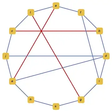

Although the question has already been thoroughly answered, here is an unusual approach to checking if a graph is planar that I'm very fond of which works well here.
First, we notice that there's a cycle passing through all $12$ vertices:
(This method is only guaranteed to settle the question one way or the other if we find such a cycle, though for a cycle that passes through only most of the vertices it can still be very helpful.)
Now redraw the graph so that this cycle is arranged in a circle:
If there's a planar embedding of the graph, this circle has to appear in it somewhere, and so the only choices left to make for how to draw the graph are deciding, for each edge not in the cycle, whether it will be drawn as a chord inside the circle or outside the circle.
But the three highlighted edges all intersect each other. No matter which choices you make for them, either two of them will be on the inside (and intersect) or two of them will be on the outside (and intersect). So there is no planar embedding.
(In general, once the Hamiltonian cycle has been found - if it exists - deciding if the remaining edges can be drawn without crossing is straightforward. Begin with an arbitrary choice and then just make sure that if an edge is on the inside, all the edges it crosses are on the outside, and vice versa.)
- 159,700
6Indeed, the second drawing makes the $K_{3,3}$-subdivision easy to see: since $l$ sees $a$ and $c$ along the cycle and $g$ along the red edge, this naturally suggests that ${a,c,g}$ should be the branch vertices for one part of the $K_{3,3}$ and ${l,b,e}$ should be the branch vertices for the other part. – Gregory J. Puleo Oct 17 '17 at 03:01
6But checking planarity does not require finding Ham cycle. Planarity is much easier problem. – rus9384 Oct 17 '17 at 07:18
3That's true! This is not a method you'd teach your computer to do on hundreds of vertices. In practice, finding a Hamiltonian cycle by hand, in a relatively small planar graph, is often easy - and you can see that this method would tell us a lot even if we found a cycle only on $10$ or $11$ vertices, though we'd be left with more casework to do. – Misha Lavrov Oct 17 '17 at 15:38
2This is similar in principle to Hopcroft & Tarjan's 1974 "efficient planarity Testing" O(N) algorithm although they look at a hierarchy of cycles formed in each biconnected component (and do not rely on finding a single hamiltonian cycle). A detailed analysis can be found in the "Planarity Testing By Path Addition" Thesis showing how the cycles are generated and chords are added (forming additional child cycles) to either the inside or outside of each parent cycle. – MT0 Oct 18 '17 at 10:19
3You're computing what's sometimes called the conflict graph of the cycle. A graph with a spanning cycle is planar if and only if it's conflict graph is two-colorable, the colors being "draw inside" and "draw outside". You can read more in the planar graphs chapter in Douglas West's intro to graph theory textbook. – Jack M Oct 18 '17 at 10:29

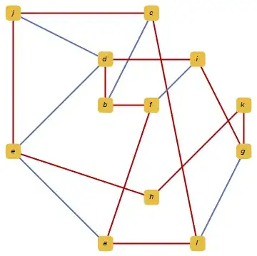

It's not planar. If you delete the vertex $j$ and the edge $bf,$ what's left is homeomorphic to $K_{3,3}.$
1Homomorphic. HomEomorphism is something else. Otherwise a nice and simple answer. – Heimdall Oct 17 '17 at 11:35
@bof My mistake. First, I meant isomorphic. Second, it's not isomorphic, it's isomorphic to a subdivision, which, as I've just found out, is called homeomorphic. (I guess because it's the same as topological homeomorphism of graphs considered as subspaces of R^3, for example.) – Heimdall Oct 17 '17 at 11:59
