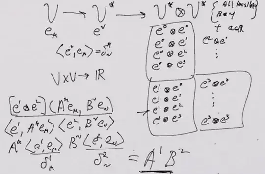

XylyXylyX has a great series of videos on manifolds and tensors. I would like to confirm a couple of points that are probably implied (or misunderstood (by me)). It makes reference to this point in the definition of tensor product:
... in the lower left-hand corner of the slide, he is illustrating the product tensor $e^1 \otimes e^2$ operating on a pair of vectors $A^\mu\,e_\mu, B^\nu\,e_\nu \in V,$ resulting in the real number $[e^1 \otimes e^2](A^\mu e_\mu, B^\nu e_\nu)=A^1 B^2.$
I would like to ask you to confirm two things:
  1. Even though $A^1 B^2$ is a real number, if we were to carry out the complete tensor product $[*]$, we'd have to express it as
$$A^0 B^0 e_0 \otimes e_0 + A^0 B^1 e_0 \otimes e_1 + \cdots + A^4 B^4 e_4 \otimes e_4.$$
In other words, it wouldn't be just a single real number, but rather more like a matrix.
This seems consistent with the result in the Wikipedia example of the tensor product of $v = \begin{bmatrix}1& 2& 3 \end{bmatrix}$ and $w = \begin{bmatrix}1 & 0 & 0 \end{bmatrix}:$
$$v\otimes w=\hat x \otimes \hat x + 2 \hat y\otimes \hat x + 3 \hat z \otimes\hat x $$
although there are no apparent covectors in this Wikipedia example, possibly explaining the difference.
$[*]$ NOTE that this may be the main source of my misunderstanding: In the example on the slide posted, he picks out $e^1\otimes e^2$, but I don't know if one has to continue operating on the $15$ additional $e^i\otimes e^j$ pairs.
  1. When the covectors (linear functionals) are not just the basis of $V^*,$ and they have coefficients, the tensor product $\beta \otimes \gamma$ operating on these same two vectors would look like
$$\beta_0 \gamma_0 A^0 B^0 e_0 \otimes e_0 + \beta_1 \gamma_0 A^1 B^0 e_1 \otimes e_0 + \cdots + \beta_4 \gamma_4 A^4 B^4 e_4 \otimes e_4$$
with $\beta_i, \gamma_i$ corresponding to the coefficients of the covectors $\beta, \gamma \in V^*.$

This is equivalent to the tensor product space $V^*\otimes V^*$ (the set of all tensor $(2,0))$ on the slide in the OP. The presenter is tensor-multiplying two co-vectors in the vector basis of $V^*$, without coefficients, yielding the $16$ pairs of basis vectors of $V^*\otimes V^*$: $$\{e^0\otimes e^0, \; e^0\otimes e^1, \; e^0\otimes e^3, \;\cdots, e^4\otimes e^4\}.$$

I don't know what you mean by "carry out the complete tensor product" in 1. But the output should be a real number, regardless, if you apply a tensor of type $(2,0)$ to a pair of vectors. Similarly, in 2, the output should be a real number when you evaluate $(\beta\otimes\gamma)(\sum A^\mu e_\mu,\sum B^\nu e_\nu) = \sum \beta_\mu\gamma_\nu A^\mu B^\nu$.
(If you like, $(e^i\otimes e^j)(e_\mu,e_\nu) = \delta^i_\mu\delta^j_\nu$, as your slide says.)

  • Thank for your answer. Please note the result of the example in Wikipedia, i.e. $v\otimes w=\hat x \otimes \hat x + 2 \hat y\otimes \hat x + 3 \hat z \otimes\hat x,$ which would be akin to my expression $(1)$ in the OP. As for $(2),$ can I interpret that it is correct? – Antoni Parellada Sep 19 '17 at 17:17
  • No, things are not correct. What "complete tensor product" do you mean in 1? If $v = \sum A^\mu e_\mu$ and $w=\sum B^\nu e_\nu$ are vectors, then in 1. you've written out the $(0,2)$ tensor $v\otimes w$. Is that what you intended? – Ted Shifrin Sep 19 '17 at 17:20
  • I meant not just applying $e^1 \otimes e^2,$ as in the example, to the pair of vectors, but the entire complement of the $16$ different $e^i \otimes e^j$ permutations listed on the slide. – Antoni Parellada Sep 19 '17 at 17:23
    No, again, if you apply a $(2,0)$ tensor to a pair of vectors, you will get a real number, not a $(0,2)$ tensor, as the answer. – Ted Shifrin Sep 19 '17 at 17:24
  • I think I got it after your answer. I posted a pseudo-answer collecting my updated thoughts, and if you don't mind taking a look at it, and it reflects the thoughts in your answer accurately, I'll consider that I understood it properly, and move to accept your post. Thanks again. – Antoni Parellada Sep 19 '17 at 20:15
    Yup, I think it's straightened out now. :) – Ted Shifrin Sep 19 '17 at 21:41
