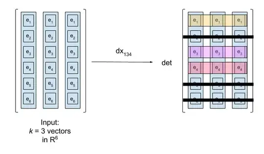

Alternating multilinear functions:
The following is an example of $\Lambda^3(\mathbb R^6)^\star:$
a function $dx$ taking in $3$ vectors in $\mathbb R^6,$ i.e. $dx_{134}(v_ {1},v_{2},v_{k=3}),$ and returning a determinant of a matrix of the rows $1,$$3$ and $4$ - the $k\times k$ matrix composed of the corresponding elements $1,$ $3$ and $4$ of the input vectors: $$\mathbb R^6 \times \mathbb R^6 \times \mathbb R^6 \to\mathbb R.$$ All these possible such operations form a vector space with basis
$$\begin{align}\{dx_{123},dx_{124},dx_{125},dx_{126},\\dx_{134},dx_{135},dx_{136},\\dx_{145},dx_{146},\\dx_{156},\\dx_{234},dx_{235},dx_{236},\\dx_{245},dx_{246},\\dx_{256},\\dx_{345},dx_{346},dx_{356},\\dx_{456}\}\end{align} $$ of dimension ${6\choose 3}=20 .$

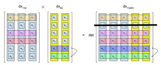

Wedge product:
The wedge product of, for example, an element $dx_{134}\in\Lambda^3(\mathbb R^6)^\star$ and an element $dx_{65}\in\Lambda^2(\mathbb R^6)^\star:$
will be an element $dx_{134}\wedge dx_{65} =dx_{13465}=-dx_{13456}\in\Lambda^5(\mathbb R^6)^\star.$
Or, as a different example, $dx_i \wedge dx_j = dx_{ij} = - dx_j \wedge dx_i = d_{ji}.$
