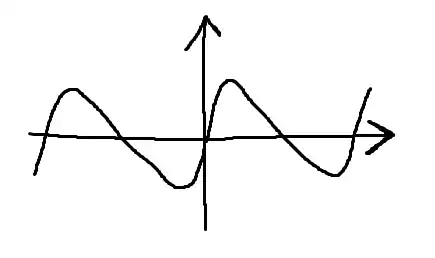

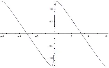

I would like to know what's the equation of a "tilted" sine, that looks like this (no idea how to show it better).
I remember first seeing this waveform in some kind of sound synthesizer, where one of the knobs for controlling shape of the sine was doing just what im looking for - gradually turning sine to sawtooth and vice versa.
I tried using fourier series on a sawtooth wave, and getting a couple of first sines together, but the result doesn't have that smoothness.

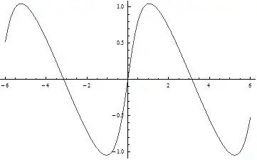

    try $\sin\left(x+\frac{\sin(x)}{2}\right)$ – Wouter Sep 15 '17 at 14:17

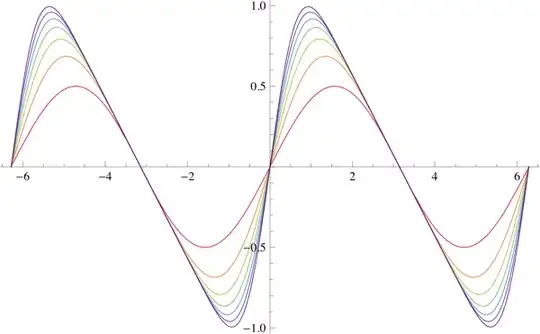

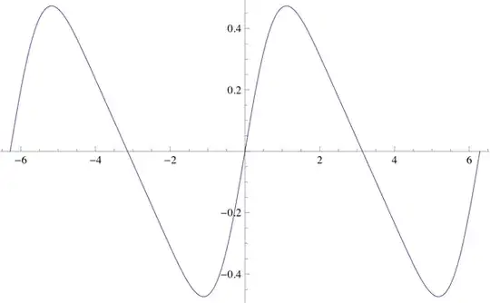

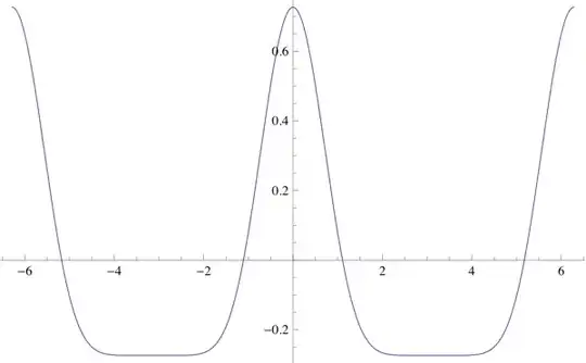

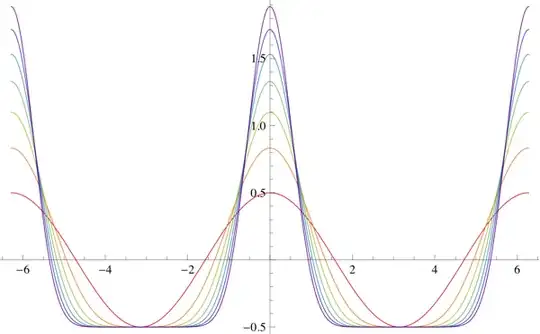

One can look at the derivative of the function and see that near $0$, the derivative is large and near half the period, it is almost constant. This hinted that the derivative might be a cosine raised to an even power minus a constant. The constant would need to be chosen to cancel the integral of the even power of cosine over a period.
For example, $\cos^8\left(\frac x2\right)-\frac{35}{128}$:
The integral is $\bbox[5px,border:2px solid #C0A000]{\frac7{16}\sin(x)+\frac7{64}\sin(2x)+\frac1{48}\sin(3x)+\frac1{512}\sin(4x)}$:
We can generalize this by noting that $$ \cos^{2n}\left(\frac{x}2\right)-\frac1{2^{2n}}\binom{2n}{n}=\sum_{k=1}^n\frac{\binom{2n}{n-k}}{2^{2n-1}}\cos(kx) $$ Then we get that the integral is $$ \bbox[5px,border:2px solid #C0A000]{\sum_{k=1}^n\frac{\binom{2n}{n-k}}{k\,2^{2n-1}}\sin(kx)} $$ The case illustrated above is $n=4$.
Scaling by $\frac{2^{2n-1}}{\binom{2n}{n}}$ gives that the integral of $$ \frac{2^{2n-1}}{\binom{2n}{n}}\cos^{2n}\left(\frac{x}2\right)-\frac12 $$ enter image description here
is $$ \bbox[5px,border:2px solid #C0A000]{\sum_{k=1}^n\frac{\binom{2n}{n-k}}{\binom{2n}{n}}\frac{\sin(kx)}k} $$ enter image description here
which, as $n\to\infty$, tends to $$ \sum_{k=1}^\infty\frac{\sin(kx)}k $$ which is a sawtooth wave.

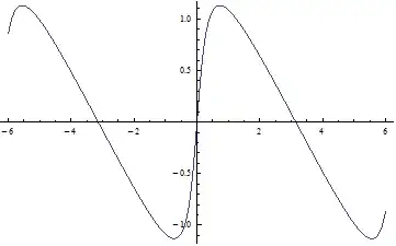

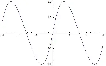

You can try this :
$$y=\sin \left( x+\dfrac yn \right)$$
Here $n \in \mathbb R -\{0\}$. Positive $n$ will "tilt" the graph left side, while negative $n$, right side.
For example,
When $n=1$, $y=\sin(x+y)$
When $n=2$, $y=\sin \left( x+\dfrac {y}{2} \right)$
When $n=10$, $y=\sin \left( x+\dfrac {y}{10} \right)$
As $n \to \infty$, $y=\sin(x)$

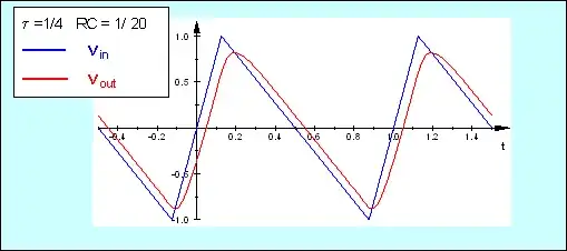

In the old signal generators, the section devoted to produce square and sawtooth waves, was commonly realized starting from a pulse train generator, in which the frequency and the pulse duration (duty cycle) were tunable.
From that, by (analogic) integration, and clipping a series of triangular and trapezoidal waves could be obtained.
The knob of your synthetizer was probably acting on a filter applied to a sawtooth wave. A low-pass (e.g. RC, or higher degree) filter should do the job.
The output of a simple RC filter
Tilted_sine_1
is given by the differential equation $$ v_{{\rm in}} (t) - v_{{\rm out}} (t) = RC{d \over {dt}}v_{{\rm out}} (t) $$
When the input is a discontinuous function, and since we are interested in the long term component of the output (the particular solution to the ODE above), it is not practical to apply the differential equation above directly, and we have better go by expressing the $v(t)$'s through a formal series, in practice the Fourier series.

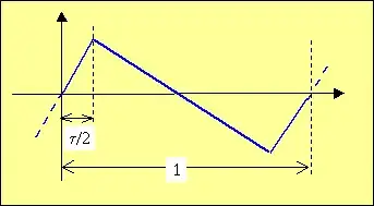

A sawtooth wave, with duty cycle $\tau$
Tilted_sine_2
$$ v_{{\rm in}} (t) = \left\{ {\matrix{ {2/\tau \,t} & {0 \le t < \tau /2} \cr {{1 \over {1 - \tau }}\left( {1 - 2t} \right)} & {\tau /2 \le t < 1 - \tau } \cr {2/\tau \,\left( {t - 1} \right)} & {1 - \tau /2 \le t < 1} \cr } } \right. $$ which is the integral of a pulse train with same $\tau$, has the Fourier series expansion $$ v_{{\rm in}} (t) = {{2\tau } \over {1 - \tau }}\sum\limits_{1\, \le \,n} {{{\sin \left( {\pi n\,\tau } \right)} \over {\left( {\pi n\,\tau } \right)^{\,2} }}\sin \left( {2\pi nt} \right)} $$

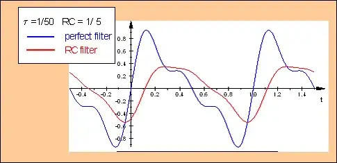

Finally, a comment on why the OP did not get a smooth result by taking the first few components of a sawtooth.
Doing that corresponds to apply an ideal low-pass filter, which is not a physically realizable device.
The RC filter is instead a physical device which, in spite of not being perfect, but introducing some attenuation and shift of phase in the frequency domain, provides the "smoothness" of the output signal.
The plot below shows the sum of the first $3$ harmonics from a sawtooth, and the corresponding first $3$ harmonics from the RC filter output.
Tilted_sine_4

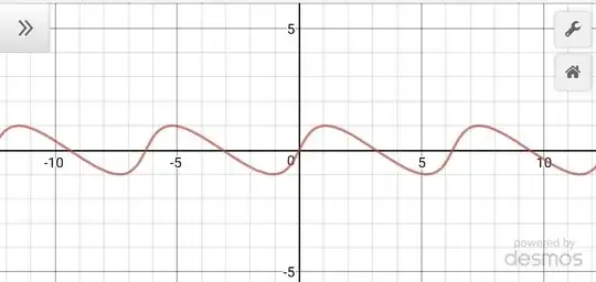

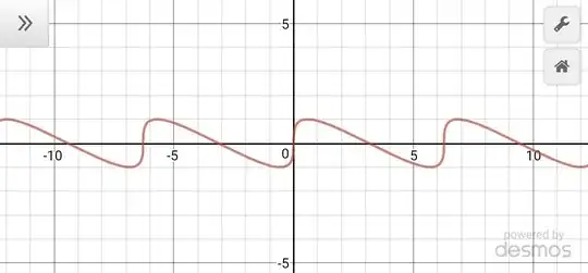

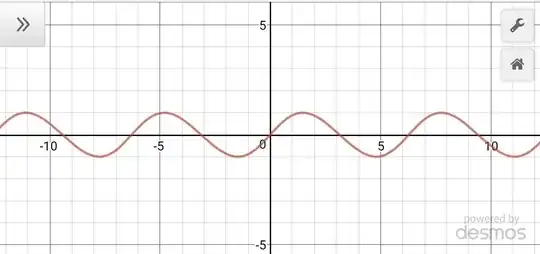

I suggest taking
$$\frac1t\tan^{-1}\frac{t\sin x}{1-t\cos x}$$
with $-1\leq t\leq+1$ where the two extreme values of $t$ give sawtooths in opposite directions, and $t=0$ is simply a sinusoid. Intermediate values of t give nice smooth functions that do indeed look like "sheared sinusoids".
(When $t=0$ exactly, taking the formula literally gives you 0/0. The limit as $t\rightarrow0$ is $\sin x$, and for values of $t$ very close to 0, it may be numerically better to take a few terms of the series you'll find below under the heading "Motivation".)
If you would like to play with this, you can do so e.g. by going to https://www.desmos.com/calculator, pasting in this formula \frac{1}{t}\arctan \left(\frac{t\sin \left(x\right)}{1-t\ \cos \left(x\right)}\right), and setting the permitted range in the slider for $t$ to -1..+1.
Here are plots for t=0.25, t=0.5, t=0.75, and t=0.95.
enter image description here enter image description here enter image description here enter image description here

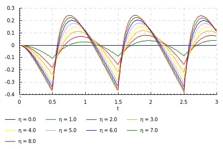

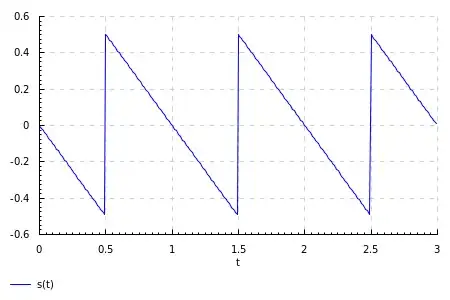

As G Cab said, a synthesizer generates such a waveform by low-pass filtering a sawtooth signal.
To describe that mathematically: we start out with a sawtooth $$ s(t) = \operatorname{round} (t) - t. $$ Plain sawtooth wave
The low-pass filter is typically a kind of state variable filter. These are named so because there is a “state variable” that's governed by an ordinary differential equation dependent on the incoming signal. The simplest form, that can be build with just a resistor and a capacitor, can be written (I'm using PDE-convention notation for derivatives, i.e. $r_t = \frac{\partial r}{\partial t}$) $$ r_t(r,t) = \eta \cdot (s(t) - r(t)) $$ Because $r_t$ depends Lipschitz-continuously on $r$, the Picard-Lindelöf theorem tells us that the solution $r : \mathbb{R}\to\mathbb{R}$ is uniquely determined by this differential equation, in other words, the above equation for $r_t$ also defines $r(t)$.
But how does it actually look? Well, we can use numerical techniques to calculate an arbitrarily good approximation to the exact solution. A common method is the fourth-order Runge-Kutta solver. Implemented in Haskell:
rk₄ :: (Time -> ℝ -> ℝ) -- the function r_t(t,r)
    -> Time             -- time-step for the solver
    -> [(Time, ℝ)]      -- sequence of solution snapshots [r(t)]
rk₄ f h = go 0 0
 where go t y = (t,y) : go (t+h) (y + h/6*(k₁ + 2*k₂ + 2*k₃ + k₄))
        where k₁ = f t y
              k₂ = f (t + h/2) (y + h/2*k₁)
              k₃ = f (t + h/2) (y + h/2*k₂)
              k₄ = f (t + h) (y + h*k₃)
If we evaluate this for the above filter $r$ with a couple of different values for $\eta$, we get this result:

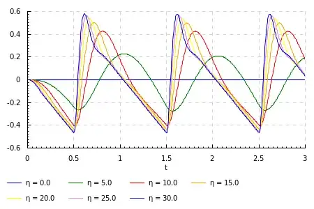

With a suitable second-order filter, we can get a better result. That requires an additional variable $u$ to be solved:
toRenderable $ forM [0, 5 .. 30] $ \η -> signalPlot ("η = "++show η) $ second fst
          <$> rk₄ (\t (r,u) -> (u, η^2 * (s t - r) - η*u)) 0.01
Sawtooth after 2nd order linear filter
Still not perfect, but a really well-designed filter can get you very close to a real sine. Filter design used to be a big research topic. Nowadays it tends to be more practical to use digitally sampled signals, then you can just perform a Fourier transform, take whichever frequency components you want, and zero out or attenuate the rest to any amplitude you like.
