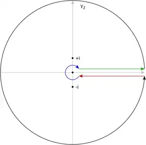

I'm trying to evaluate the integral of $\frac{z^{\frac{1}{3}}}{(z+1)^2}$ on the following keyhole contour. enter image description here
I am using the branch cut of $[0, \infty)$.
In the solutions to this question, it is said that along the green line we can write $z=xe^{0 i}$ and along the red we can write it as $z=xe^{2 \pi i}$.
Can someone explain why this is so? I'm having a hard time understanding why, because the green and red line avoid the branch cut, and hence the arguments aren't actually $0, 2\pi$ respectively.

  • @mathworker21 Yes, but the question is in relation to finding the integral of $\frac{x^{\frac{1}{3}}}{(x+1)^2}$ from $0$ to $\infty$. So I'm using the method of finding the integral on the closed curve (as you said), then showing the line integrals on all but the red and green lines tend to zero as the inner circle's radius tends to zero and the outer's to infinity. – hhattiecc Apr 21 '17 at 17:11
    in the limit where you get infinitly close to the branch cut with your contour the argument is indeed $0$ or $2\pi$ – tired Apr 21 '17 at 17:12

From the previous discussion, we know that $z^{1/3}$ has logarithmic branch points at $z=0$ and $z=\infty$. We choose to cut the plane along the positive real axis.
With this choice of branch cut, if we approach a point on the positive real axis along a contour in the first quadrant, then $\arg(z)$ approaches $0$. If we approach a point on the positive real axis along a contour in the fourth quadrant, then $\arg(z)$ approaches $2\pi$.
Referring to the diagram in the OP, we can formally parameterize the green (red) segments as $z=x \pm i\epsilon$, $x\in [\sqrt{\nu^2-\epsilon^2},\sqrt{R^2-\epsilon^2})$, where $\nu>0$ is the radius of the blue-colored circular arc centered at the origin and $R$ is the radius of the gray-colored circular arc. Then, we have
\begin{align} \lim_{\epsilon\to 0}\int_{\sqrt{\nu^2-\epsilon^2}}^{\sqrt{R^2-\epsilon^2}}\frac{(x+ i\epsilon)^{1/3}}{(x+ i\epsilon+1)^2}\,dx&=\int_\nu^R \frac{x^{1/3}}{(x+1)^2}\,dx\\\\ \lim_{\epsilon\to 0}\int_{\sqrt{\nu^2-\epsilon^2}}^{\sqrt{R^2-\epsilon^2}}\frac{(x- i\epsilon)^{1/3}}{(x- i\epsilon+1)^2}\,dx&=\int_\nu^R \frac{x^{1/3}e^{i2\pi/3}}{(x+1)^2}\,dx \end{align}
