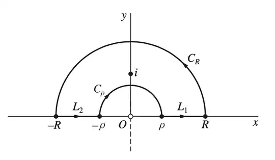

The question asks to compute $$\displaystyle\int^\infty_0\frac{(\ln x)^2}{1+x^2}\,dx$$ but I have no idea how to do that. I have thought about using the following branch cut but doesn't seem to work. enter image description here Branch Cut Here

  • That contour won't help unless you convert the integral to one on $(-\infty,,\infty)$. But a keyhole contour, $\gamma$ say, would be useful. You can compute $A_n:=\int_0^\infty\frac{\ln^xdx}{1+x^2},,0\le n\le2$ by expressing $B_n:=\oint_\gamma\frac{\ln zdz}{1+z^2},,1\le n\le3$ [sic] in terms of them, then evaluating the $B_n$ by the residue theorem. – J.G. Apr 19 '22 at 16:13
  • (Sorry, $A_n,,B_n$ should be respectively defined in the above comment as $\int_0^\infty\frac{\ln^nxdx}{1+x^2},,\oint_\gamma\frac{\ln^nzdz}{1+z^2}$.) – J.G. Apr 19 '22 at 16:22
