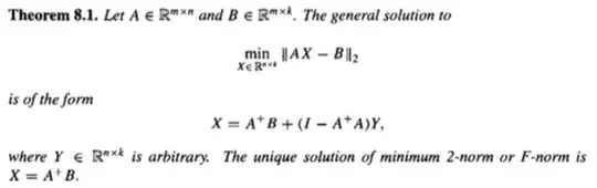

In Laub's book (p. 66), he shows the solution is in general an affine space: Laub excerpt

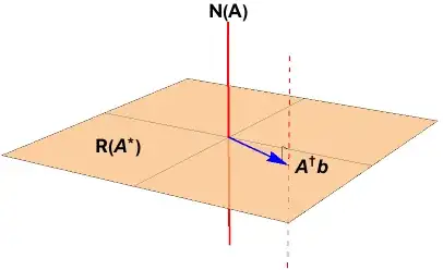

represented as the dashed red line in the figure below.
a dagger b
