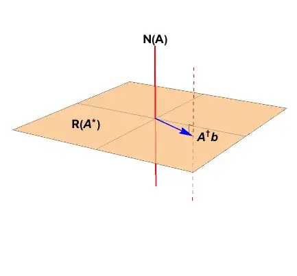

As you noted, the least squares solution can be written as $$ x_{LS} = \color{blue}{\mathbf{A}^{+} b} + \color{red}{\left( \mathbf{I}_{n} - \mathbf{A}^{+} \mathbf{A} \right) y}, \quad y\in\mathbb{C}^{n} \tag{2} $$
Fundamental projector
The right hand component is the fundamental projector onto the $\color{red}{null}$ space $\color{red}{\mathcal{N}\left(\mathbf{A}\right)}$ $$ \mathbf{P}_{\color{red}{\mathcal{N}\left(\mathbf{A}\right)}} = \color{red}{\left( \mathbf{I}_{n} - \mathbf{A}^{+} \mathbf{A} \right)} $$ The least squares solution is the affine space represented by the $\color{red}{red}$, dashed lined. The projector projects vectors onto this $\color{red}{null}$ space. (Note the solution of minimum norm is $\color{blue}{x_{+}} = \color{blue}{\mathbf{A}^{+}b}$.)

The general solution to the homogeneous system of linear equations $Ax=0$ is given by $(I-A^+A)Z$. Hence the name.
