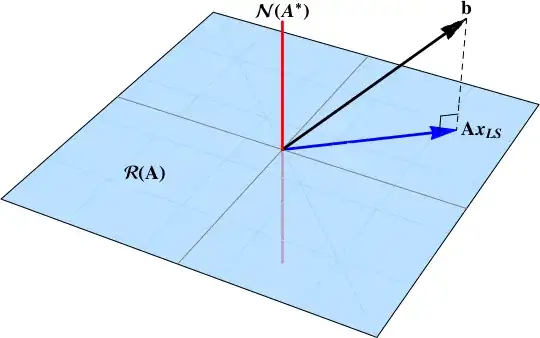

The resort to least squares in an admission that the data vector $b$ has a null space component $$ b = {\color{blue}{b_\mathcal{R}}} + {\color{red}{b_\mathcal{N}}} $$ And there is no solution such that $\mathbf{A}x = b$; there is no combination of columns of $\mathbf{A}$ which produces $b$. The least squares solution finds the projection of the data vector onto the range space $\color{blue}{\mathcal{R}{\left(\mathbf{A}\right)}}$.

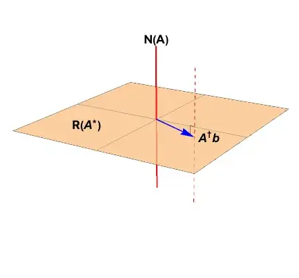

The solution is $$ \mathbf{A} x = \color{blue}{b_{\mathcal{R}}} + \color{red}{\left(\mathbb{I}_{n} - \mathbf{A}^{*}\mathbf{A} \right) y}= \color{blue}{\mathbf{A}^{+} b} + \color{red}{\left(\mathbb{I}_{n} - \mathbf{A}^{*}\mathbf{A} \right) y}, \quad y\in\mathbb{C}^{n} $$

The null space $\color{red}{\mathcal{N}\left( \mathbf{A} \right)}$ is trivial. The solution space is entirely in $\color{blue}{\mathcal{R}\left(\mathbf{A} \right)}$
