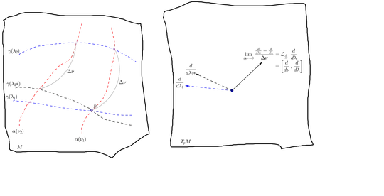

Yet another, slightly different approach below :
The problem of course is that we can't compare vectors at different points ( different tangent spaces ) of a manifold when we don't know how to transport vectors from one tangent space to another.
If we want to generalize the notion of a directional derivative to vector fields (and other geometrical objects) on a manifold we have to be able to transport a vector from tangent space to another nearby tangent space in which we can take the difference of two vectors and divide by some notion of a distance.
In absence of some other structure on the manifold the only simple way to do this is by using the concept of Lie dragging a vector field along a congruence. This way we arrive at the Lie derivative which is most fundamental.
The other derivatives are just special cases of the more fundamental Lie derivative.
Lie derivative :
Let $M$ be a manifold with no extra structure ( in other words : no metric or parallel transport ) defined on it.
The notion of a vector field can be viewed as a congruence of curves ($\gamma(\lambda_{\sigma})$) defined on $M$.
The notation : $\gamma(\lambda_{\sigma})$ means that every value chosen for $\sigma$ defines an individual parameter $\lambda_{\sigma} \in \mathbb{R}$ to be used on one-and-only-one of the (space-filling) family of curves $\gamma()$ that define the congruence. So choosing a value for $\sigma$ is the same as choosing an individual curve on the congruence with its parameter $\lambda_{\sigma}$ , the values for $\lambda_{\sigma}$ then range from some $a \in \mathbb{R} $ to some other $b \in \mathbb{R}$. Choosing a value for $\lambda_{\sigma}$ is choosing a point on the selected curve.
Every point $p \in M$ is on exactly one of these curves $\gamma(\lambda_{\sigma})$ , then $\frac{d}{d \lambda_{\sigma}}$ defines a vector in the tangent space $T_pM$ of every point $p \in M$ . Therefore a congruence defines a vector field.
Since a congruence provides us with a way to correlate every point $p \in M$ with a unique curve on the congruence together with a specific parameter value on that curve, this means that a congruence also gives us a way to map all points of $M$ to different points by adding a value $\Delta \nu$ to their corresponding parameter values on their corresponding curves.
This way we can also project curves on a congruence ( and therefore on $M$ ) to other curves a parameter distance $\Delta \nu$ away. This is Lie dragging.
Now if we have two congruences : $\gamma(\lambda_{\sigma})$ and $\alpha(\nu_{\beta})$ we are able to Lie drag $\gamma$ a parameter distance $\Delta \nu$ along the $\alpha$ congruence. This gives us a way to compare the original $\gamma(\lambda_{\sigma})$ curves to the ones that were dragged along $\alpha$ by a parameter distance $\Delta \nu$ (the latter we can call $\gamma(\lambda_{\sigma}*)$ ) at the same point $p \in M$ .
So now in $T_pM$ we have two vectors : $\frac{d}{d \lambda_{\sigma}}$ and $\frac{d}{d \lambda_{\sigma}*}$.
The Lie derivative is now defined as : $\mathcal{L}_{\frac{d}{d \nu}} \space \frac{d}{d \lambda} = \lim_{\Delta \nu \to 0} \frac{\frac{d}{d \lambda*} - \frac{d}{d \lambda}}{\Delta \nu}$ ( we see that $\Delta \nu $ now serves as a measure of distance for lack of anything else to work with ).
It turns out that this is equivalent to : $\mathcal{L}_{V} U = [V, U]$ .
Lie dragging
