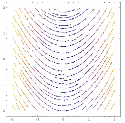

I'm trying to understand the Lie bracket operation $[X, Y]$ as the rate of change of $Y$ as seen by an observer moving along the flow of $X$.
Example 1
Suppose $X=\{1, x\}^T$ and $Y=\{1, 0\}^T$, then $[X, Y]=\{0, -1\}$ and the flow of $X$ is $\{t+x_0,\frac{1}{2}t^2+ t\ x_0+ y_0\}$.
But I'm failing to see how along any of the flows below, the rate of change of vector $\{1, 0\}$ is $\{0,-1\}$.

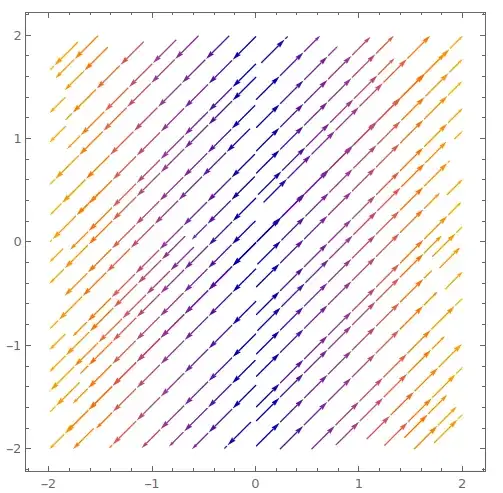

Example 2
Suppose $X=\{x, x\}^T$ and $Y=\{1, 0\}^T$, then $[X, Y]=\{-1, -1\}$ and the flow of $X$ is $\{e^t\ x_0,e^t\ x_0-x_0+y_0\}$.
Again from plot below I'm not able to see how the directional derivative makes sense. enter image description here

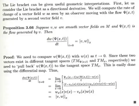

Adding except from the source. enter image description here

  • Thanks for clearing that up. But I'm trying to understand how the Lie bracket $[X, Y]$ itself is a directional derivative. Does it mean that $-\partial_y$ is the rate of change of $Y$ as seen by an observer moving along the flow of $X$? (This statement is from p. 61 of this book https://www.academia.edu/84388355/Nonlinear_Control_and_Analytical_Mechanics_A_Computational_Approach.) – Suba Thomas Nov 06 '23 at 04:31
  • I have added the excerpt from the book. They use $v$ and $w$ instead of $X$ and $Y$. – Suba Thomas Nov 06 '23 at 19:06
    Thanks. This shows that -with the flow definition- ${\cal L}_XY=[X,Y]$ holds as well. Conclusion: unlike what I wrote in a now deleted comment: The Lie derivative is in general not a directional derivative $\partial_XY,.$ It is the difference of two such directional derivatives. Finally, ${\cal L}_XY=[X,Y]$ it is the rate of change of $Y$ as seen by an observer that moves with the flow of $X,.$ – Kurt G. Nov 06 '23 at 20:20
  • This takes me back to the original question. I have the plot for the flow of $X$. I'm trying to visualize on the plot how the rate of change of $Y={1, 0}$ for an observer moving along that flow is ${0, -1}$. I'm imagining a vector $Y$ (basically constant and pointing to the right) at each point of the flow. If I am moving along the flow, how am I seeing the rate of change of $Y$ as ${0, -1}$? – Suba Thomas Nov 06 '23 at 20:44
    The screenshot from the book shows a slightly more readable version of something that is often presented in ponderous ways like this. Some DGs seem to believe that the more intimidating a notation is the better. Trying to visualise this you have my full sympathy. I think that the point is that in the $t$-derivative we have to find ways to compare vectors that live in different tangent spaces $T_xM$ and $T_{\Psi(x,t)}M,.$ ... – Kurt G. Nov 07 '23 at 05:29
