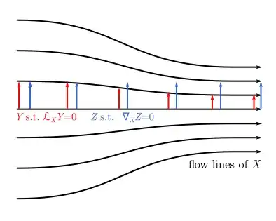

Here's a qualitative illustration I have lying around, showing the difference between a vector field having zero Lie derivative and zero covariant derivative.
Certainly doesn't capture the whole idea, but might help. I think the main idea I was trying to communicate is that covariant derivatives are all about a single flow line of $X$, while Lie derivatives care about all of $X$.
