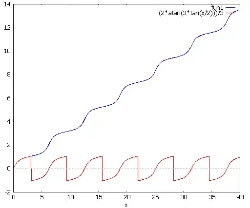

Here is a plot showing the difference. The correct antiderivative (with $C=0$) is in blue, and the expression given by the CAS in red.
Notice that on all intervals $]2k\pi-\pi,2k\pi+\pi[$, the antiderivative given by the CAS is correct. It just has to be shifted properly on each interval to get a function with only removable singularities at $(2k+1)\pi$, and after defining the values at $(2k+1)\pi$, you get a continuous antiderivative on $\Bbb R$. That's how $F$ is defined above.

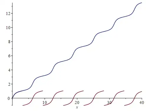

With Maple, the indefinite integral fails as expected, by giving the simpler $\frac23\arctan(3\tan(\frac x2))$. However, it seems smart enough to give a correct solution for the definite integral, with int(1/(5-4*cos(t)), t=0..x, AllSolutions);
The result, with no editing apart from translation to LaTeX:
$$\frac13\left\{\begin{array}{lr} 2\pi\lceil-\frac{\pi-x}{2\pi}\rceil+\left\{\begin{array}{lr} \pi, & -\frac{\pi-x}{2\pi}\in\Bbb Z \\ 2\arctan(3\tan\frac x2), & \mathrm{otherwise} \end{array}\right., & 0<x\\ 2\pi\lfloor-\frac{\pi-x}{2\pi}\rfloor+2\pi-\left\{\begin{array}{lr} \pi, & -\frac{\pi-x}{2\pi}\in\Bbb Z\\ -2\arctan(3\tan\frac x2) & \mathrm{otherwise} \end{array}\right., & x\le0 \end{array}\right.$$
It's not the simpler answer $\frac x3+\frac23\arctan(\frac{\sin x}{2-\cos x})$, but at least it will give the correct result for the integral on $[0,2\pi]$, when evaluating $F(2\pi)-F(0)$, where $F(x)$ is the expression above.
And here is the plot of the expression above in blue, together with the computed indefinite integral in red:
Other computer algebra systems may be able to do the same, possibly with extra options (here AllSolutions is required for Maple to give the full answer).
